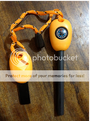

Got a couple of ferro rods off ePrey.
This one . . .
Came in a box that closely suggests Light-My-Fire. Note "Army." But low-wage translator used. Instead of "patented product," we get "paterted prounct Counterfeit reserved'" No company name. No country of origin (CHINA). Phony patent number.
Sparks OK, but not to close to LMF standard.
The other one performs about the same, but the box insists, "Free Tinder in Handle." Handle is solid plastic.
So just acceptable for kids to use for practice

China may be the source of each and every ferro rod, but not all ferro rods are created equal. The MMF "Army" threw lots more sparks with the same scraper as compared to these two items.
My bottom line, after laughing at the "paterted prounct Counterfeit reserved," is just that it's wise to try out critical gear before needing it.

I had the same experience as chopsuey9999 with the Coghlan's firesteel, it sparks great, but after just a few weeks the steel came out of the handle. I left it that way, because its large enough to use it without a handle and stores in a sheath "kit" easier. :)
Pretty much the same experience here. Had a rod fall out of its glued retainer. I just zip tied the rod to my Becker necker sheath.
I've made the handles come off..... big vicegrips and a hacksaw work well. it was always a fair bit of work though. not like you can't still use them, so its not that big a deal to me.
Just got one of my generic steels from the bay. it was a blank, no handle. Just a quick couple strikes with the back of the saw on my Swisstool (sharp square spine) pretty reasonable sparks. not gobby, but strong enough to get some sparks to last from just above waist height to the ground. About the same as the old LMF I have.
Just got the other firesteel in. Its the biggest I found with a handle(8mmx90mm). It also came with a striker. the striker has very fine teeth on one side, and man does it rip off sparks. again, about as good as my older LMF and Primus steel, so I'm quite pleased with it. Not bad for a couple of bucks. I should now have enough firesteels to last a couple decades! I handled up the blank by gorilla gluing some gutted line green para to it. Nothing fancy, just enough to get a better grip.
