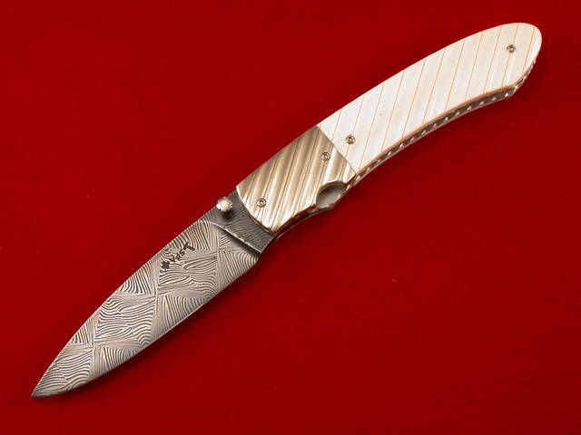

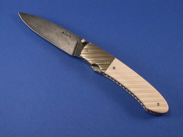

Hello gentlemen, today I share with you photos of a gentleman's folding knife.

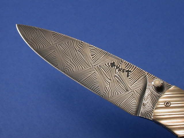

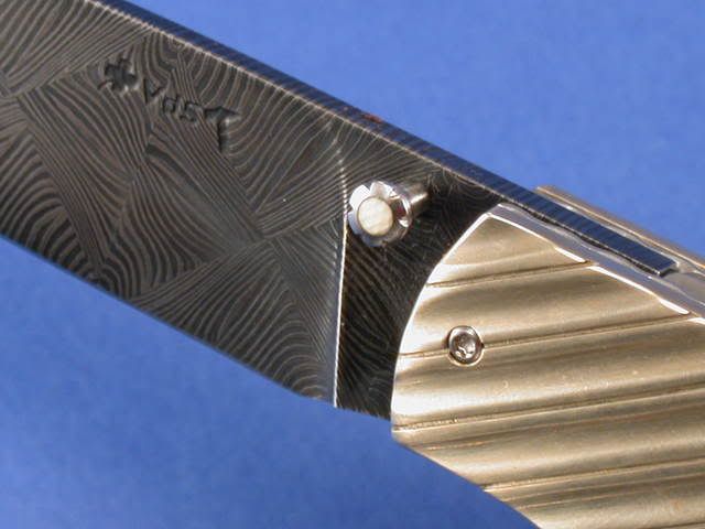

This piece is Linner lock with mosaic Damascus blade in radial pattern, satin bolsters in alpaca and ivory scales both flutted.

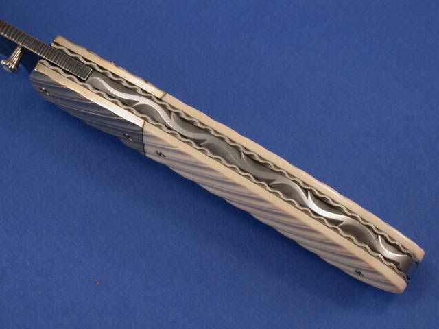

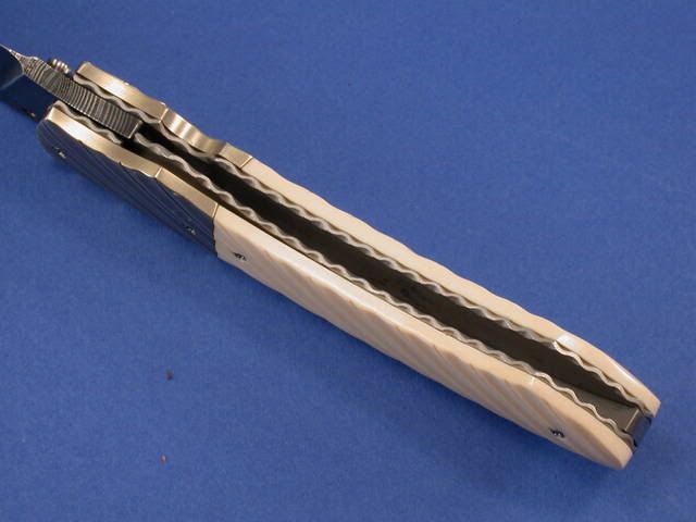

The linners are stainless steel also the screws, the axis of the blade, the ball of detention, the spacer and the release button with a small ivory inserts.

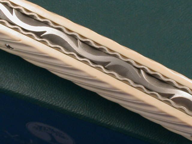

The linners have a filework around the contour of sinusoidal pattern with blasting finishing. The spacer shows a filework in vine pattern, satin finishing and blasting in the background.
Measurements: 90mm blade, 210mm overall length.
We hope you enjoy the photos.

Nice work!
The fluting and file work are very tasteful-it all flows. :thumbup::thumbup:
Beautiful work! I could definitely see myself carrying something like that.

The piece is handsome without the enhancements, but with the fluting and filework, the WOW factor is in that knife.
