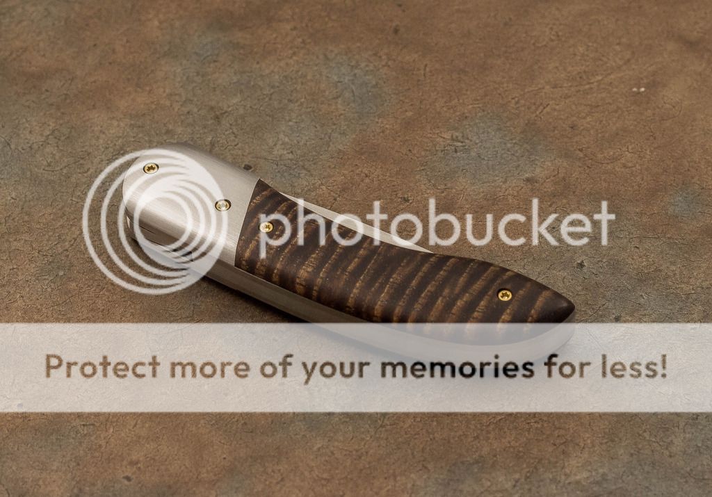

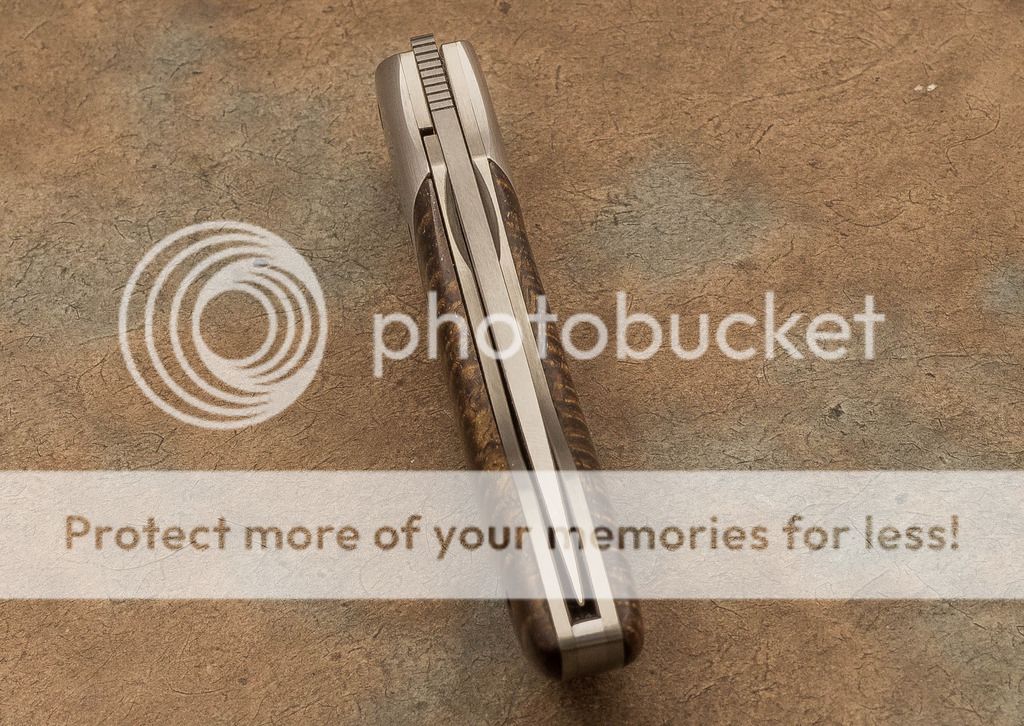

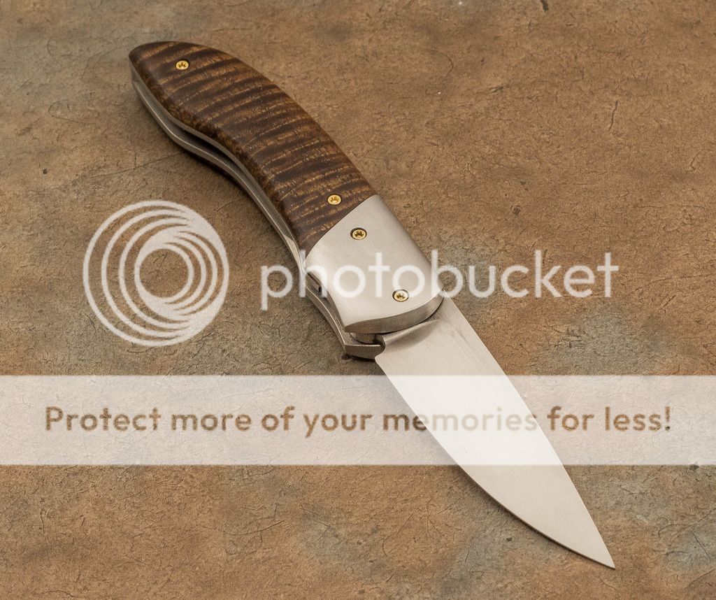

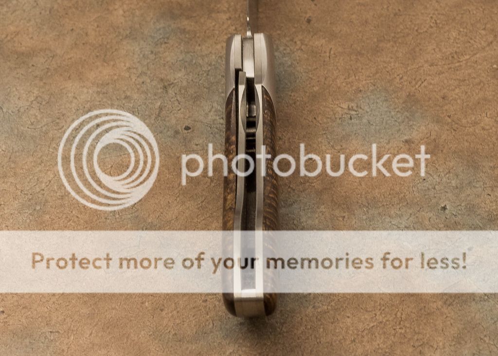

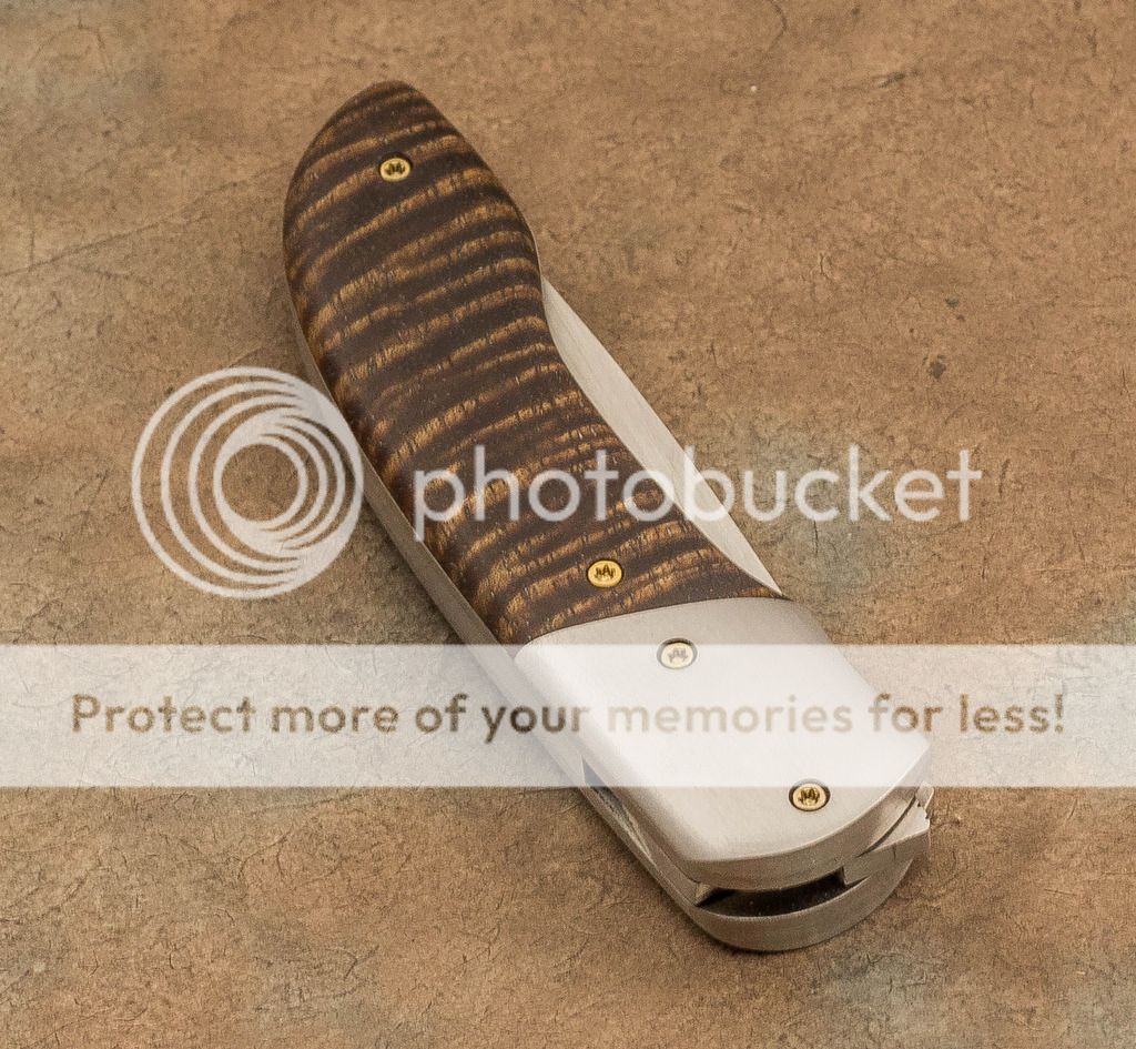

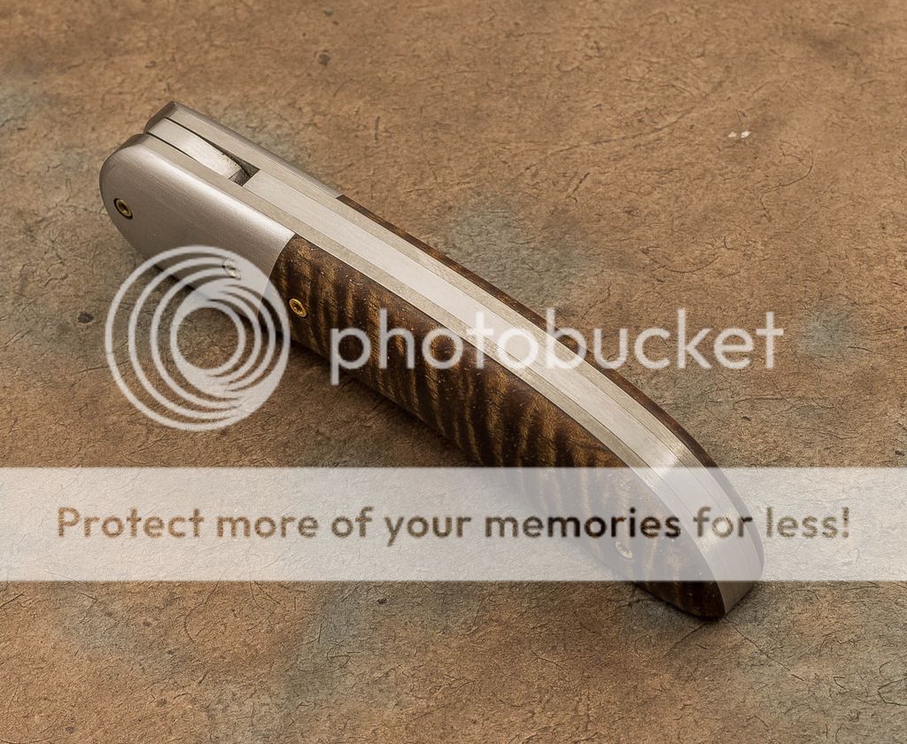

Here is the first of 5 Gentleman's folders I am doing in this run. This one has stabilized koa, hardened stainless bolsters, titanium liners and a CPM-S30V blade @62RC. I wanted to keep this model clean, so no thumb studs. It deploys from the front, but is not designed to be a flipper. Blade length is 2.5". Thanks for looking.

It's a nice useful looking design, but the liners and scales look chunky enough to be called fat.
How thick are the liners?
Much as I truly love koa, the design might be well served with pearls or fossil ivory scales.

STOUT - STOUT is the word STeven :D Made to work without fail in spite of its otherwise diminutive size. STOUT little fellow :thumbup: and pretty damn nice looking too. I'm calling mine Bocote Bart. Story to follow.

That is a very nice looking knife. But, I DO agree with STeven. Also, I think it would look better with mosaic pins.

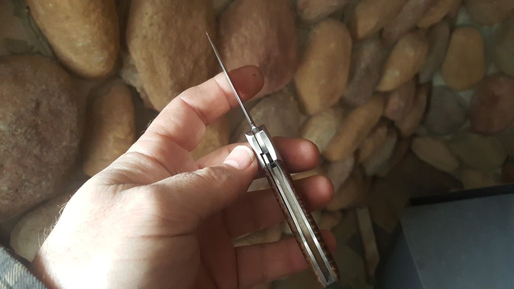

Thank you Steven. As Ray mentioned, this knife was designed to be stout. I wanted this to be an overbuilt knife for its size. There are also 3 alignment pins and 4 assembly screws holding it all together for strength and rigidity. Some areas only allow for a 2.5" pocket knife, and when needed, not many people complain of a knife that is too sturdy. Even so, I think maybe the photos might be a little deceiving. Overall length is only 5 3/4". Liners are .060" (which is exactly what I needed for the extra thread length and lock strength). The scales are under 1/8" thick at their apex which is about as thin as I would go on most scale materials that are screwed on since these are contoured and the edges are much thinner. The total thickness is .483". The only thing I would really consider "overly" thick on this knife would be the blade (therefore the spacer too). I will post an in hand photo of the knife below for proper scale. The scale material was chosen by the customer from some really nice koa he had. I have more ordered with mammoth and I plan to do a pearl version as well.
Thank you T.K.C. Not sure where you would rather see mosaic pins on a linerlock.
