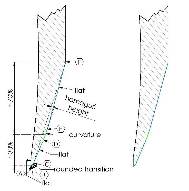

I have been thinking lately (watch out!) about blending the shoulder of the secondary bevel with the primary. In other words, begin the sharpening process by establishing the edge, and then feathering that shoulder into the bevel while doing the post heat treat grind. I hope that makes sense....and I am most positive that many of you guys do that exact thing on a regular basis. This will be my first.
Any tips like that for superb slicing geometries?
I think I understand what you are saying?
On some thicker blades, daggers, and swords, I establish the edge with a 45 degree grind on each side. Then I shape the bevels to the pre-HT shape. After HT, I re-establish the bevels and finish up to a 400 grit belt. Then ( especially on Japanese swords) often blend the edge back into the bevel just as you describe. I do this on the slack belt or on a rotary platen ( Beaumont). The rest is taken care of in hand sanding and sharpening.
In Japanese sharpening, this is called an "apple seed" grind. Westerners often just call it a convex grind, or a Moran grind.
Yep....you get what I'm after. And the apple seed shape of the katana was one inspiration to do this. Not going for a "convex" grind on the primary, nor the secondary, but a smooth transition between the two. I think basically it will be a flat cutting edge...convex transition.....flat primary bevel.

Here is a visual reference that may be of interest. I have posted at least one of them before in a thread discussing urasuki. Even though they directly pertain to kitchen knives and only a single sided bevel, they seem to show something similar to what you describe. I thought they were cool.

Perrin...that's hilarious! :) Your cross sections were well received...I've seen them before. Great pics. Stacy....thanks for the DVD offer. Once I get there....I might just take you up on that. I want to improve fit/finish more before I tackle something like that. When I mentioned W2, I thought to myself, Stacy is going to say "choose a different steel". I agree with ya. Maybe 1075 one of these days!

I posted some videos of Jim Crowell doing what I think you are talking about. A flat grind with a convex edge, Appleseed, Moran edge whatever. What a lot of the ABS smiths do. Didn't see a video anywhere explaining it.
Is that what you are asking about?
ShawBlades...yessirrreee that is exactly what I am talking about......for the most part. Pretty much. Dead on...almost. I think in all actuality that I am referring to the Moran edge. And stupid me....I've even heard of that term and knew what it was! But isn't a Moran edge convexed? As in the whole edge is a radius? This is what I did....after the 120 grit finish, I cut the edge in, about 25 degrees inclusive, on a 120 grit stone. Then I proceeded to knock off the shoulder created by the edge with 120 grit, and then blended it in with the final polishing. So the edge itself is still flat, so are the primary bevels. But the area of primary/secondary intersection has been blended, so to speak. I hope that explains it a little better.
