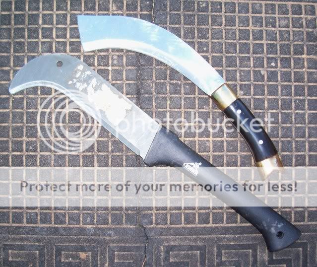

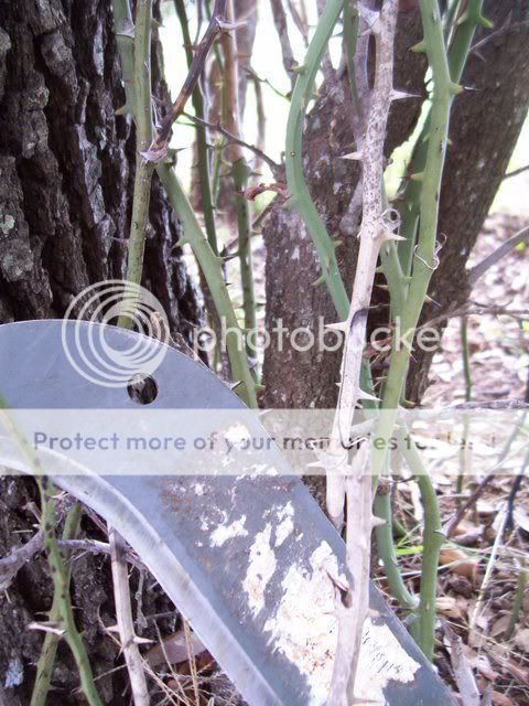

I use these all the time around our property. We have a horrible sort of brier that grows up inside the drip line of the oaks that are all over our property, they are tough and thorny and evil, and I hate them. I've been on an ongoing battle against them using various sizes of brushhook, the Gerber/Fiskers version being the smallest.

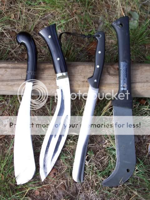

I prefer these types of tools to more traditional big knives like khuks or goloks for brier clearing because the hooks have, well, hooks! They are also inexpensive and quite tough.
The cutting I do often requires me to chop very close to the ground, and you never know what will be lurking in the brush. Could be fence posts, wire fencing, cable, or rocks, but the brush hook has an advantage over standard shaped blades in a couple of areas. First, they grab these tough, thorny devils and don't let them go until they are cut. Standard blades often just push the vines out of the way without cutting. Also, the tip of the hook usually will impact whatever object might be unseen, rather than wrecking the nice edge.
The brush tool is made of some kind of stainless steel, and it usually has a grayish coating as well. The handle is a hollow plastic which is nicely formed and lightweight. The knife blade is about 1/8th" thick.
The blade steel is pretty soft, I've not been able to break one. The edge will roll, but is easily resharpened. I usually do this on my belt grinder, but if you don't have one of those, a fine file will work as well.

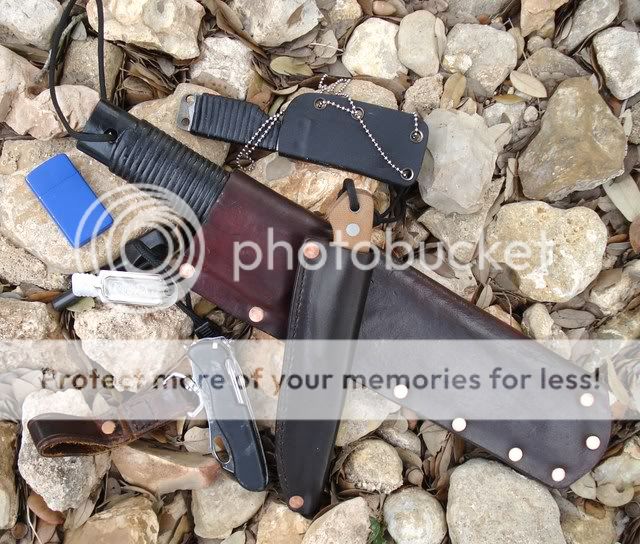

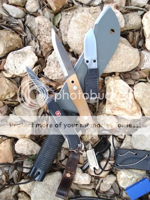

These hooks are also easily changed into something else, like a camp knife, which is what I've done here by just cutting off the hook and the end of the handle.
These tools could be of real interest to a person camping or hiking. They are lightweight, lighter than a hatchet of similar length. They are tough. They can be used to dig, or to clear a campsite. They can baton.
They are ugly and have no soul. But I keep coming back to them for the particular work I do so much of around our place, clearing brush. A downside to these blades is that they are usually sold without any kind of sheath, but they can be found separately.

Andy, thanks for that photo thread on the Jblade. I took one of these Fiskars in trade last year and never did anything with it. I see the potential from what you put one through! I did'nt know you could actually baton with this thing? You have a nice selection of knives there, good looking Koster Bushcrafter, and I have the OHT myself. Looks like you took the serrations off your OHT main blade. I saw in Cabelas the last time I was in PA, that they sell the Gerber version in a sheath. I asked one of the store lackeys if they could get me a separate sheath, and he said no, they only sell it like this.
Glad to hear that they are so durable, won't have to buy a machete if this thing can handle the same type work. Your Golok is nice looking too, BRKT? I also notice you're pretty creative when it comes to leashing your knives.

You are very welcome! That is a BRKT Golok, another very nice and useful blade (but not as inexpensive.....!).

Andy, When filing/sharpening the edge on this is it similiar to honing a hoe? It looks like a V edge, have you ever tried to convex the edge on one? I would think that edge would last longer, especially with a softer steel. Did you make your sheath?

By the way those are greenbriars .deer will feed on the tips in bad weather

IIRC, most hoes are chisel ground, the brushhooks have a standard "V" grind. I do convex mine on my belt grinder.
I did make the sheath for the camp knife version, but not for the standard size.
