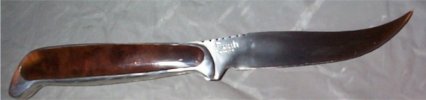

I made this knife to the specs of a avid hunter that has done alot of caping. The agrssive relief on the spine is for better clearance when rotating the blade in tight qtrs. The blade is 3 5/8 in. The scales are anodized aluminum with afziel burl inlays. I have made this knife with both S30 & 3V, the users seem to like the 3V much better. I have hunted all my life but I never performed or even watched a caping job. I would like your thoughts on this design, I try to make what clients want and appreciate any input I can get. Personaly I prefer all wood or micarta scales, but it seems most people prefer the flash & shine of polished blades & handles.
Thank You
