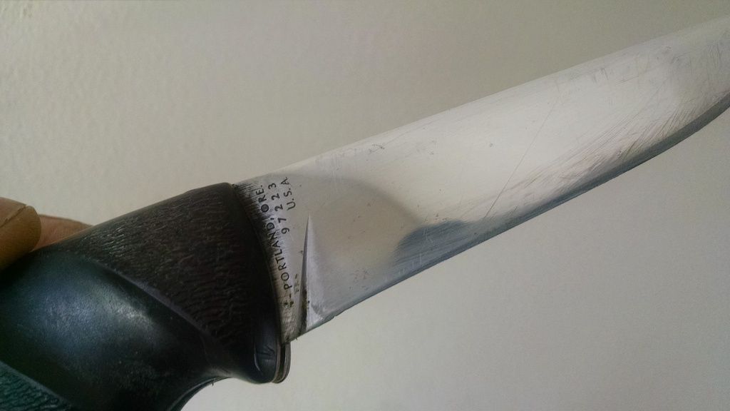

Here's a customers knife I haven't got to sharpening yet.
Chrome plated m2
Whoa
From some reading I guess they did make M2 Knives with chrome plating.

Here another one with a wood handle.
Sharpened great on diamond
I thought it was really hard 440c
Blade was very chrome like though.

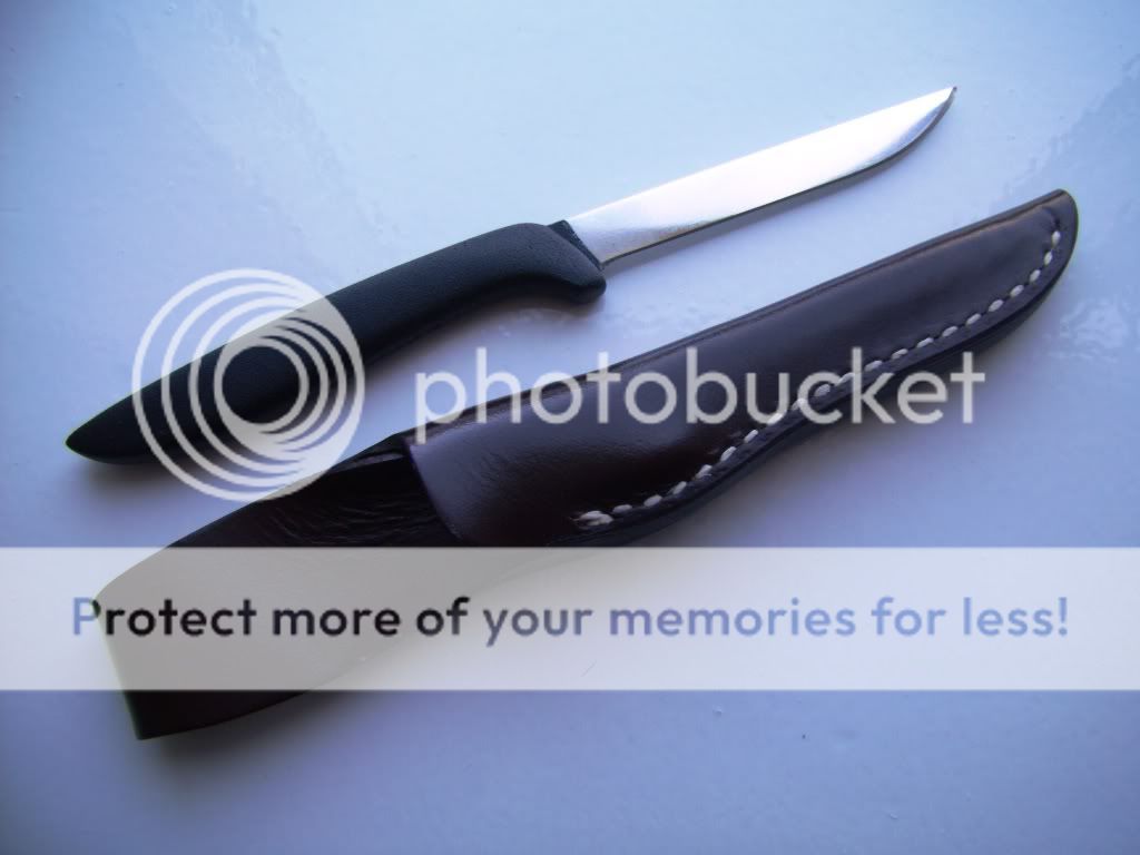

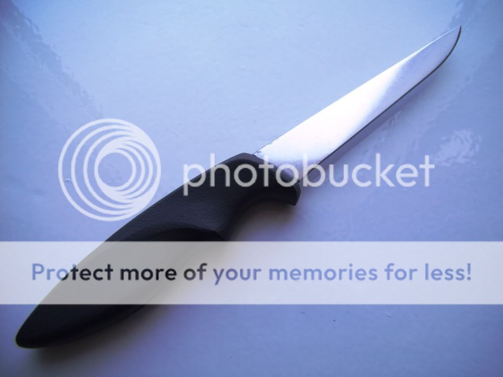

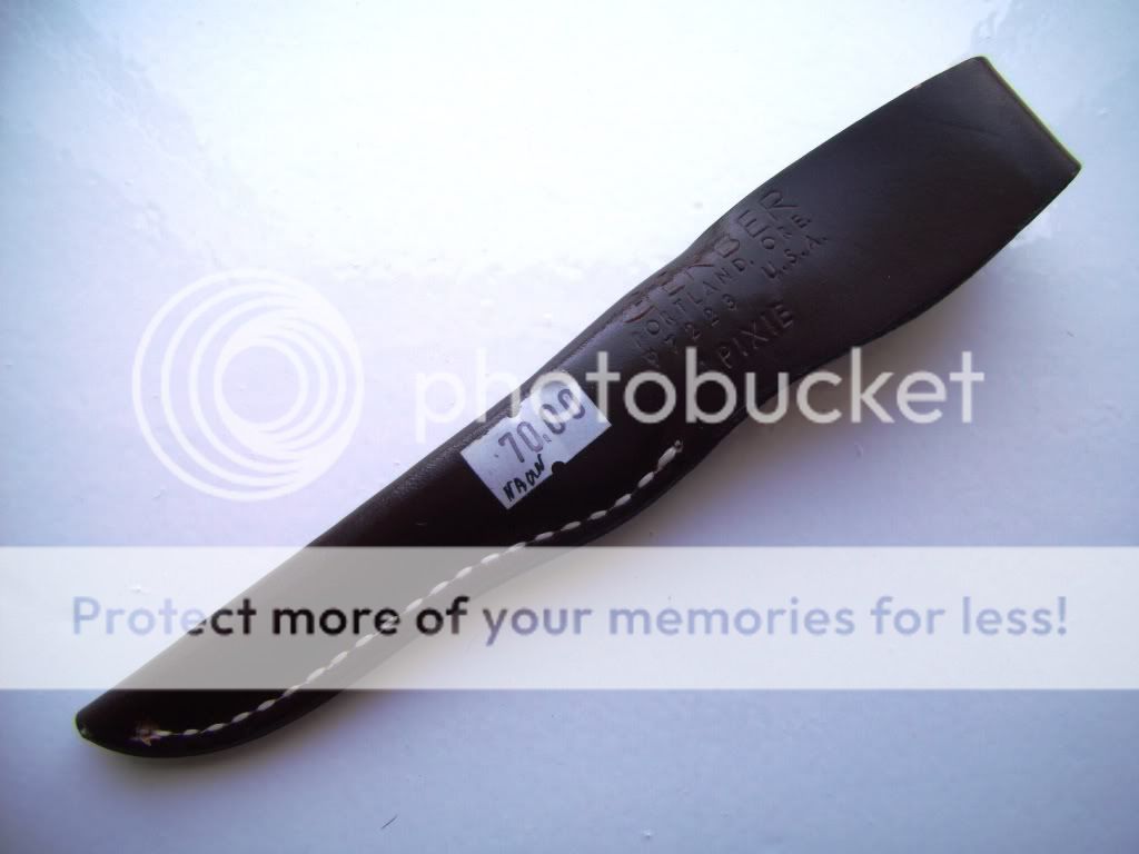

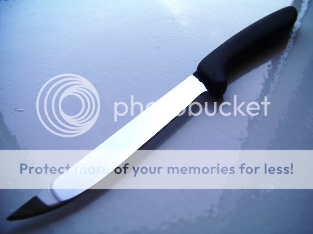

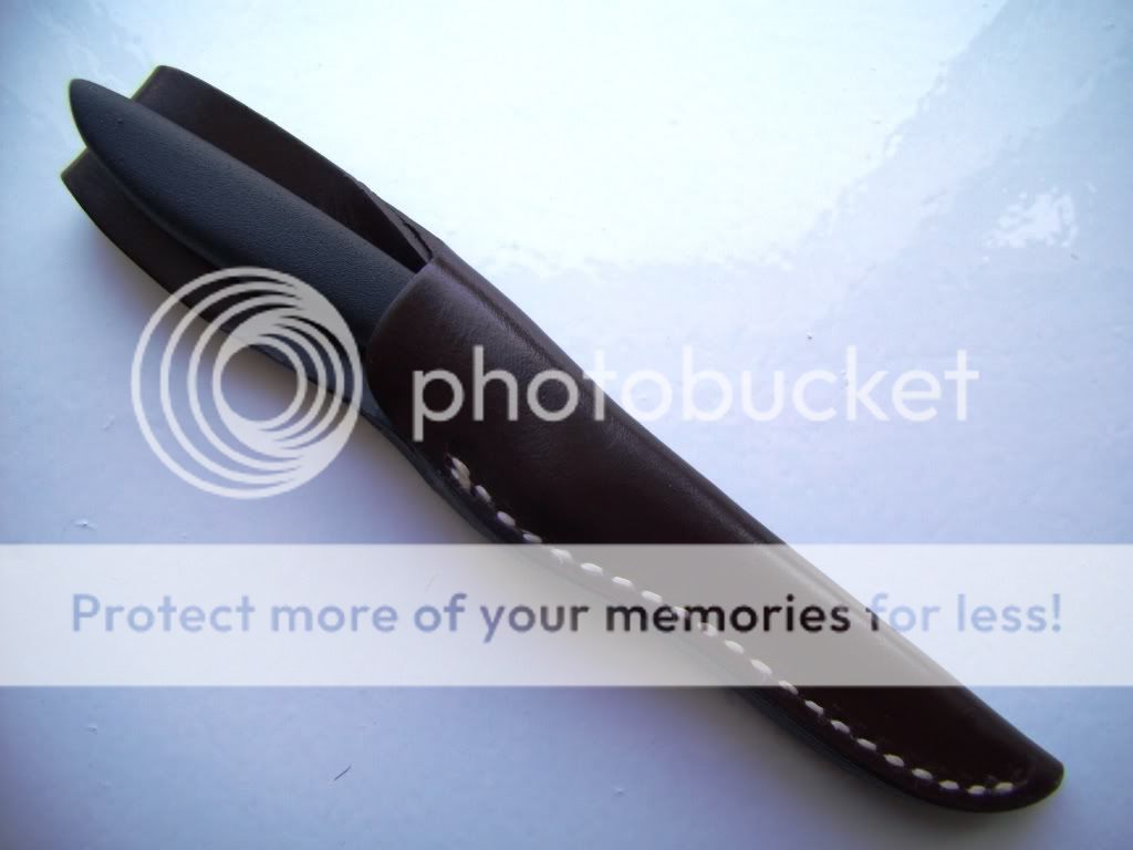

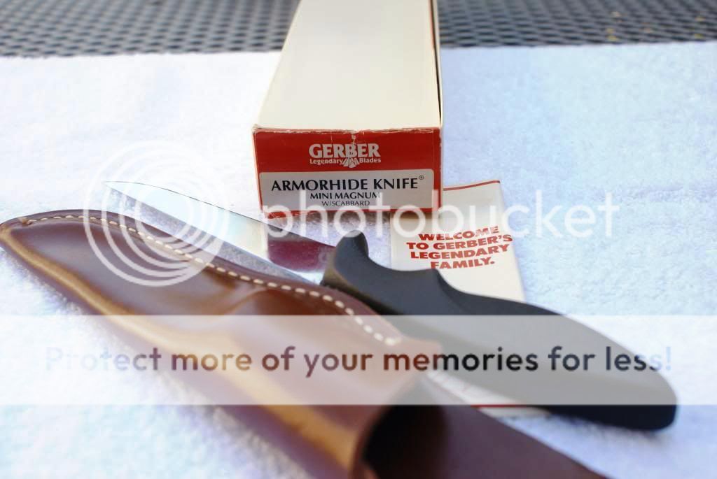

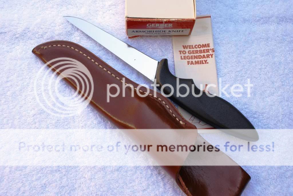

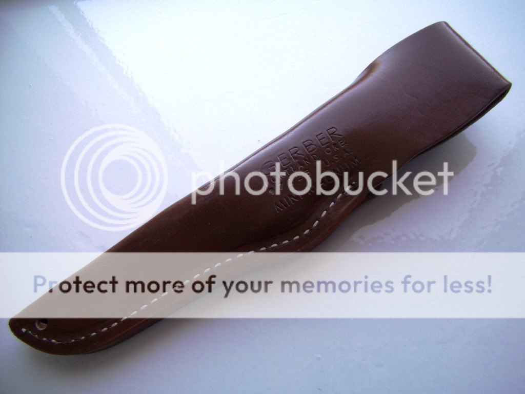

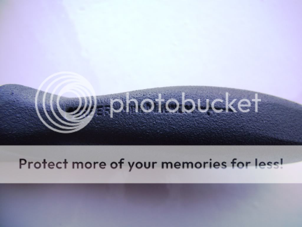

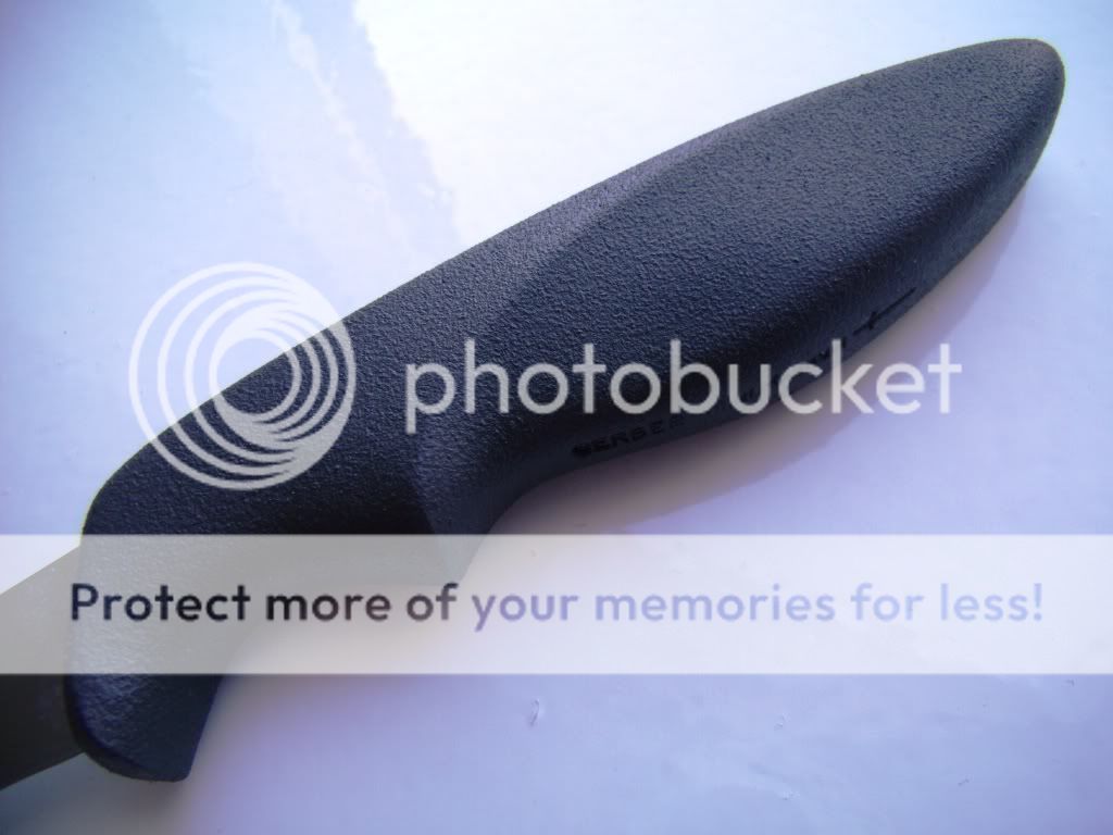

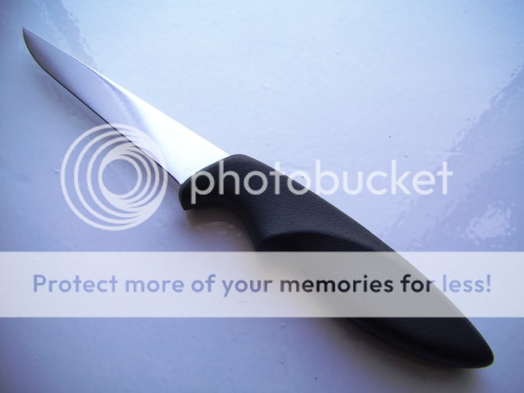

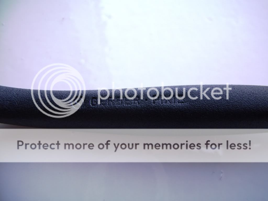

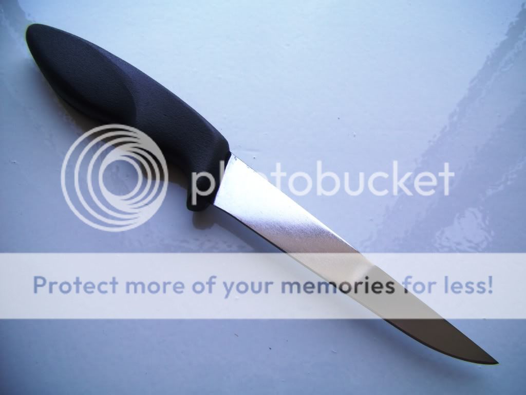

If the knife has a sword on the handle next to the brand name & model then the blade is M2 high speed steel with a hard chrome top layer, like on this Gerber Mini Magnum:
But if the knife has a capitol "S" inside a circle on the handle next to the brand name & model then the blade is 440C stainless, like on this Gerber Pixie / Bird & Trout:
I use the dmt extra extra coarse diamond stone(usually makes quick work of any steel,s110v included) to set most of my super steel edges,then I make my way up to a ceramic stone.I have a few of the m2 Gerbers and have used the dmt ,they take nice edges.

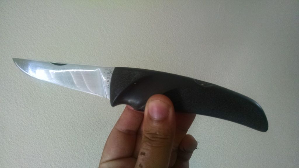

K kwackster Not sure if you’re still active on here - doing some research on a Gerber Shorty that my father gifted to me years back. On the underside of the handle it reads, “GERBER SHORTY”, no sword, no circled S, nothing besides those two words. Any idea what this means in terms of steel type and dating?
My father has a memory as bad as me, but he believes he got it around 1968. Could be that it predated Gerber’s stamping in this regard.
Open to replies from anyone who has info on these Gerber armorhide-handled knives. Thanks.
Years ago I had a nice collection of the Gerber Armorhide knives, one was the Shorty.
The grey coated aluminum handles had M2 steel with a chrome plating to prevent rust. Excellent in their day however, were not popular due to difficulty in sharpening the M2 steel.
