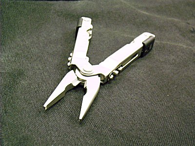

The needle-nose pliers incorporate wire cutters and a wire crimper (below the pivot).
Those who've seen the movie Blade remember the "assault pliers" scene in which a vampire snaps open a multitool to deploy the jaws and pull another vampire's fangs. A firm snap of the wrist will cause the Multi-Plier's needlenose jaws to slide out and lock into place. Spring-loaded metal push buttons on either side of the tool sit in sliding tracks and must be pushed simultaneously before the jaws can be retracted. The jaws themselves contain fine traction grooves, an enlarged circular section (which is serrated) and a pair of wire cutters. Opposite the pliers pivot is a wire crimper.

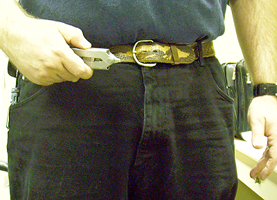

With the pliers head retracted into the body of the tool...

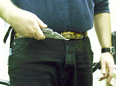

...a firm wrist snap will release and lock the jaws in place.
The pliers work reasonably well but always feel a little shaky because the sliding pliers head has a little play in it when locked in place within the handle halves. The action of the pliers (not to mention the slide-out feature) was a little gritty out of the packaging, but smoothed right up with use. The same was true for the grooved plastic tabs that form the lock releases for the interior tools. After a few openings they operated much more smoothly than the did straight from the plastic clamshell. The springs used to retain the locks are clearly visible when looking through the inside of the handle halves. (Gerber's packaging proclaims this the Saf-T Plus locking system, "The safest, strongest, most durable lock available." Like many multitools, the handle halves bear abbreviated sections of marking for metric and English distance measurements.

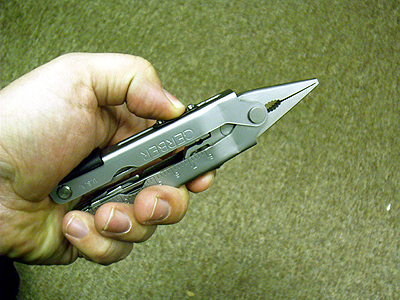

Pressing the spring-loaded buttons on both sides allows the user to retract the pliers.

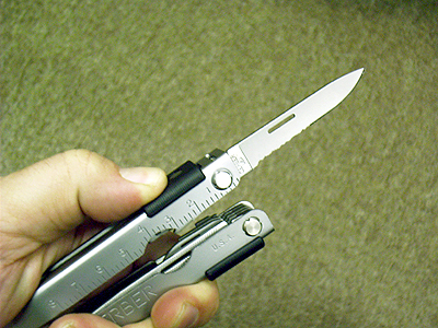

The interior tools cannot be opened (nor the handles separated) unless the pliers are deployed. Fit and finish of the components is good, though you'll either love or hate the rounded, bead-blasted look, feel, and construction of the various drivers and blades. The Sportsman Multi-Plier contains a caplifter, can opener, awl, file, primary knife blade (which is partially serrated and roughly three and a half inches long), and two flat-head screwdrivesr (the tip of the file can serve as a large flat-head screwdriver, too). There is also a slide-out lanyard ring.
Sliding these spring-loaded, grooved plastic tabs releases the interior locking tools.

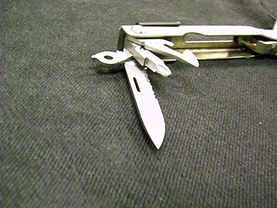

The tool includes a file,two flat-head screwdrivers in different sizes, a caplifter, and an awl.
Thanks to its rounded surfaces, the Multi-Plier feels comfortable in the hand. Overall fit and finish are pretty good -- particularly when you consider the low price of this tool. I've seen it some stores for under $22 USD (as of this writing) and some discount stores sell it for even less than that. The pliers do rattle a little in their housing once locked in place, but I can live with that.
The Multi-plier bears a partially serrated primary blade, can opener, Phillips-head screwdriver, and fold-out lanyard ring.
