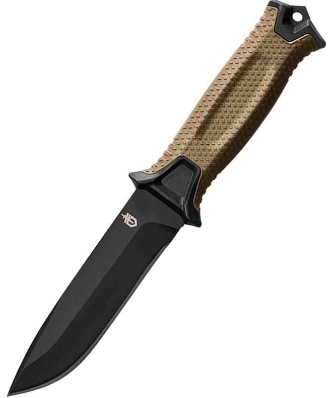

US made Strongarm VS Chinese made Strongarm :
Sharpening :
US made : Edge was Fubar & poorly ground , took a fair amount of effort to regrind 80 grit on the wet stone grinder .
Chinese made : Even more Fubar & even more poorly ground ! Took 3 times the effort compared to the US Gerber .
Conclusion : Both knives were ground by trained chimps ? The US chimps seem to be better trained than the Chinese chimps ? .. Though it's nothing to crow about !
( I heard there was a shortage of people in the US knife industry ) Anyone looking for a job ?
Anyways , been wanting to do a compare'o for a long time now ! Head to head so to speak .
Some people rave about the Strongarm and yet others poo poo it something fierce . ( Which knife is raved about and which knife poo poo'ed ? )
Only the US knife had a factory edge and it was rubbish . The Chinese knife lost it's factory edge a long time ago .
So both knifes got a fresh regrind . Actually I ground a few knives while I was at it , one way to kill time on a Friday afternoon since the humidity was high .
But those Gerbers really took a lot of effort . ( Geez )
So , anyway ! As soon as time permits and the humidity drops bellow 50% I will slice rope .
Now I wont mix up the knives cos .. The US knife is brown and the Chinese knife is black .. So no mixing them up .

I ground the Gerber first and the Chinese second ... Thinking I could simply place the clamp at the same place and replicate the first grind ( Wrong ) ..
The two knives are ground with enough variance to induce a rather large error ...
3 Degrees actually ..
Gerber was 17 degrees ( 250 )
Chinese was 14 degrees .. ( 350 )
I picked up on it only after I started slicing with the Chinese made knife .. Edge roll went to the Chinese knife by 100 slices . But the test is invalid ..

So ... Where are we ? I just did a guided knife sharpener edge on both knives at 17 Degrees ( per side ) . I should have done this first ( I guess with 20/20 hindsight )
17 degrees being what the Gerber had Factory .
So both knives now have samo samo edges . And I will do this from the beginning .. And after testing the guided edges , do another 80 grit grind ..
Oh well ! Sometimes life is FUBAR .
Ok !!!
17 degree edges done on the guided knife sharpener ..
Gerber rolled out another 250 Roll .. Matching the first test almost exactly the same ..
Chinese rolled out a 150 Roll with a 17 degree edge , that's some 200 slices less than with the 14 degree edge ..
Both knives have been on the wet stone grinder , this time with the 60 grit wheel ( cos it was on there ) .
And ground as near 17 degrees as I can .. So till next time ...

Alright :
Gerber StrongArm = 250 / 250 and 300 with a 60 grit grind ( wet stone grinder ) .. So we saw a slight increase with the 60 grit wheel .
Chinese StrongArm = 350 / 150 and 350 with a 60 grit grind ( wet stone grinder ) .. Hmmm , looks like the Chinese StrongArm likes the ground edges . This time around both edges are as near Gerber Factory angle as I can do .
