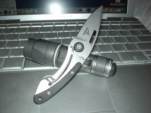

The Gerber Trendy and Surefire E1L, pictured "artistically."
Need I mention it's pretty small? Opened, it appears to be a little less than an inch longer than the Surefire E1L. Gerber recommends the Trendy for attachment to a keychain, and since it is just a little bit bigger than my Leatherman Micra in length, I would agree. Another recommended usage is as a money clip, and I have been experimenting with that over the past week. I like it as a money clip, because it is much slimmer than my current wallet and also provides for a knife easily at hand yet concealed in plain sight. Unlike my other knife, the Benchmade Mini-Griptilian 556, it is barely noticeable clipped to my pocket and completely inobtrusive. I attribute this to its obviously smaller size.

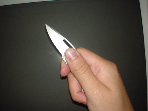

Gerber says you can open it one-handed. I find this difficult. To open it one-handed, I grip the middle of the blade and flick my wrist, so that the handle swings open, then adjust my grip for actual use. I find this less than optimal, but it is indeed a one-handed knife.
From my experience with the Gerber Trendy and the Gerber LST, it seems to me that Gerber is fond of what I'll call a "pinch-the-sides" grip, as opposed to what I believe is a more conventional grip, such as on the Griptilian, where the thumb rests on the spine of the blade. The placement of the liner locking mechanism also reinforces that observation, as holding the Trendy in a more conventional grip appears to dangerously put the index and middle fingers in a position that may disengage the locking mechanism. Thus, I hold the Trendy in such a way that is illustrated below.
Gripping the Trendy.
There is a little bit of play between the blade and the handle when open and locked, but this is after being constantly opened and closed throughout the period of one week. When I first bought it, there was no noticeable play. I think this is acceptable, though it may warrant a little Loc-tite on the retaining screw at some point.
*img snip*

I think some of these style knives are only ground on one side. Is this ground on both sides? From the depth of the grind it looks like it is. As for the grip, I guess one one taught me how to hold a knife properly; I find it unnatural to put the thumb on the spine.
