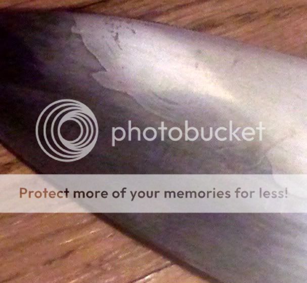

There's a maker on the forums that's making me a custom kukri with a Hamon. All the pics that he's sending me have me really interested in this process.
He says he's rubbing with warm vinegar or FeCl, then polishing at 2000 and 2500 grit, but since i don't know ANYTHING about this stuff, it got me to wondering if this is the way that most custom makers get a nice well defined hamon.
5160 is a tough steel to get a good hamon with. Your maker is skilled if he can get any sort of activity beyond a wavy line.
He might get a quench line, or some sort of a temper line, but a true hamon on a steel with that much alloy content is all but impossible.
For a hamon you need a shallow hardening steel, like 1095, W1 or W2, or tamahagane. 5160 is about as deep hardening as steel gets.
5160 has only .60% carbon, and about 1% chromium and around 1% manganese. This makes it harden deeply and slowly. 1095 has 1% carbon, only .35% manganese, and no chromium. Tamahagane has even less manganese. These steels need an extremely fast quench, and to attain a hamon, you need to use the fastest method you can. 5160 given that severe a quench could be severely damaged. Even if it isn't cracked, it may have severe internal weaknesses.

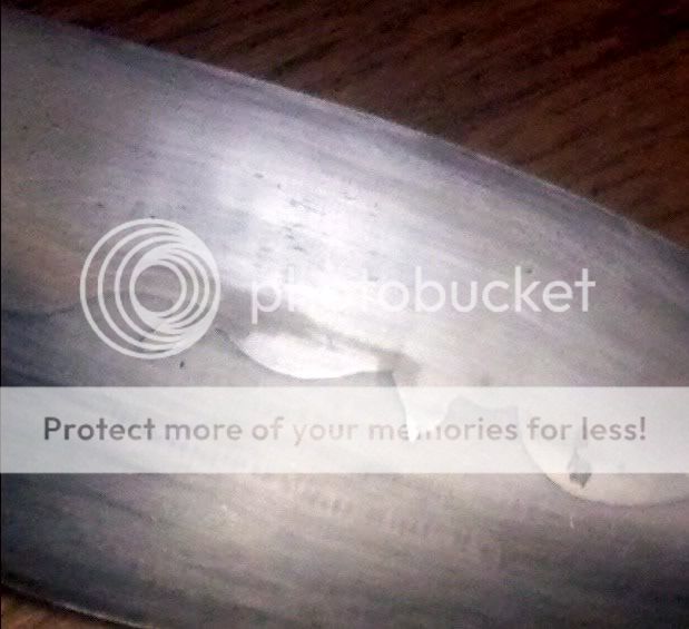

Here's what he has so far. It's looking quite nice as far as i can tell
I understand that it might not be a real genuine hamon, but i'm more interested in the look than the function in this case

For a hamon or quench line the maker could bring it to a high polish and etch. I went to a very clean 1000 grit and used a light lemon juice etch for a nice quench line on 5160. I only tried this a few times just to see how the hardening was going. I no longer differentially harden but it looked cool.
I am surprised to see even that much of a wavy line on 5160, has it been ground and etched or is that with the clay just off? It looks etched, that is wild!

that has not been etched. It is polished up to i believe 220 grit so far. He says he'll be taking it to 1500 before etching then up to 2500 or 3000 as a final polish

Off hand, that doesn't look like a temper line at all. It seems to be surface decarb. I can't tell from a dark picture and don't want to claim unfounded things about another maker's work, but I get marks like that from clay, too. Once is gets ground off, it won't come back. It is superficial. I might be wrong so don't take this as a dig on your maker. It would be nice to talk to him about it.
The line was created during the heat treat by the gentleman to whom my maker sends all his blades for HT. It was (if i am remembering correctly) created with clay.

If that really is a Hamon, my guess is that the maker used something other than 5160. Probably 1095.
It looks like surface decarb. Maybe you are not interpreting the maker's explanation correctly. It would be good if he chimed in.
That does have the simple tu-tone look of a quench line in 5160. I haven't really seen it done with that much of a pattern to he line before, though. I am a bit dubious that the blade in this pic has not been etched.

Actually, seeing Rick's post there, it does look more like decarb up close. The steel at the edge being darker and lower. Oddly, with W2 etc, the opposite effect will occur in water- the hard edge will stand proud and white of the soft back as quenched.

I got this from 1084FG...
It was obviously surface decarb but cool as heck. After I removed the decarb layer it was gone. The only thing that remained was a cloudy line about half way up the blade... not even worth etching out.
Not doubting the maker's word, just thought maybe some miscommunication possibly. Sounds like that's not the case. And I think Darrin is a good guy and knows what he's doing, it would be interesting to hear if he's got an advanced method for 5160 quench lines. Not that he needs to share it. Just an interesting thread, is all. Enjoy your kuk!
Did i H/T that blade? Yep. Any special gris-gris added? Nope. Just a wavy clay coat and regular H/T for 5160. I'm thinking there is still some decarb there also but I could be wrong. Maybe Nick will chime in and tell us about it.

Yep, Darrin put a clay temper on there. BePrepared wanted a distinct two-tone hamon line, and as Rick has pointed out, that seems to be all but impossible with this type of steel. I don't think that getting a "real" hamon is going to be possible at my skill level (which, for these purposes, is negligible), and certainly the two-tone line I think is representative more of some sort of a san mai construction. The pics I received for what he was looking for were from claudio-cas's work, and I'm pretty sure he used a san mai to get those looks. The closest I can come is to carefully etch with FeCl along the line that showed after heat treat, so that the front part of the blade is more oxidized (patina?), than the back portion. I hope I'm using the right terminology. I'm using FeCl and some q-tips along the line (maybe that's the decarb you guys are talking about? I'm still too new at this to understand the terminology perfectly) to create the effect that was requested. Is it a true hamon? Not in the slightest. Does it look interesting aesthetically? Well, I think so, and I hope BePrepared does too. If not, well, he doesn't have to pay for it unless he likes the blade. It's a cool project, and it's a good chopper. Darrin's heat treat really holds up nicely. Some day I hope I'll have the equipment and skill to make a san mai version of this blade, and get it to look just the way I want. That day, alas, is not today.
One of the things I also learned while attempting to get the hamon to come out is that if you missed any scratches during the polishing phase, they get revealed in a big way when you etch. Also, white vinegar does very little to 5160. It's been a good learning process, and I think I'll be asking darrin to do a few more clay lines on some 1095 so I can see the difference on those as compared to the 5160.
