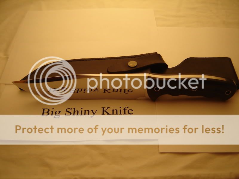

If its really badly dinged up start with 220 or 320 rubbing straight lines lengthwise. Then move up to 400 and sand diagnal to the blade until all previous grits scratches are removed. Once you think you have those scratches gone check it in both flourescent and incandescent light at different angles to make sure. Go to 600 grit and sand at a 90 degree angle to the blade until all of the 400 scratches are gone. Then check again in the lights. Go to 800 and sand lengthwise and repeat light check. Continue those steps as high of a grit as you have available. You'll really start to see the mirror look right around the 1200 - 1500 grit levels. You'll also notice that the higher numbered grit papers wear off much faster and once they load with metal dust they'll start to give you more of a polish than a scratch pattern but there is still scratches there. Once you are at 1500 or so, if you have a buffer with rouge you can put a really shiny mirror finish on.
Remember to dull the blade until you are done or you'll cut yourself. Trust me! It also helps to back the paper with something rigid and flat such as a piece of micarta or hardwood. If you don't have a buffer, take a pair of old jeans and cut them up and wrap it around whatever you used as a sanding block. Load that denim up with chrome polish and polish until you don't see scratches.
You can polish a 220 grit scratch pattern to a mirror finish with a buffer but if you look close you'll still see the ridges and valleys of the 220 grit scratches. The sanding at different angles and grits gets rid of those deeper ridges and valleys and smooths them out flat. Its just a matter of getting those ridges and valleys smooth enough that the naked eye can't see them anymore.
Doing it this way will give you a killer mirror polish but it is a lot of work and uses a lot of sandpaper. Take your time and don't skip any of those steps and you'll be amazed at how shiny you can make a blade. Like this:

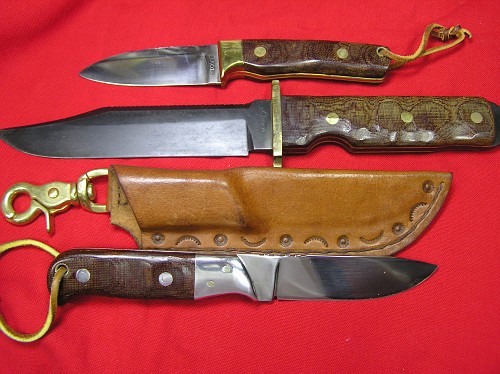

Not the same quality finish as Garret Schmidt shows but a step up for me. It comes with a stone wash finish. Most of the final work is done by hand. This is one of my EDC knives with an S30V blade steel. Not the best picture showing the final finish.

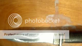

Of course I took a picture for you.
What it looks like now.

Here is an example that I did by hand. The top photo is the before shot. I stopped at 320 because I wanted a satin finish but from here just hit it with 400, 600, 800 and 1200 and finish with your polish. I've used Flitz and Mothers mag polish with mirror finish results. Also, like Garrett Schmidt stated before, you can jump to polish sooner but you will still have small scratch ridges on close inspection.
