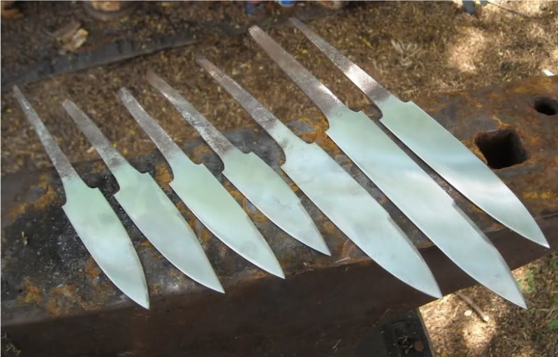

Ya I want to try other styles of knife that might be more friendly to forging. Any suggestions?
Yup, a hidden/through tang:
http://i665.photobucket.com/albums/vv18/GHEzell/DSCN0047.jpg
These can either pass through the pommel and then threaded or peened (european sword style), or they can be a little shorter than the handle and have a hole(s) drilled for a pin (japanese sword style)... or any combination thereof... the tang needs to be thickest and widest at the blade/handle junction, tapering in thickness and width to the end of the tang. This is common knowledge among knifemakers, but you did ask...:)
