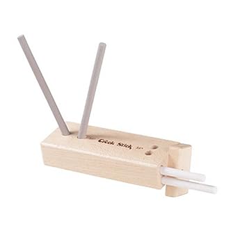

the lansky 4 rod ceramic ? i use it for knives like my DOUK DOUK or a Buck 119 and it's very good.
