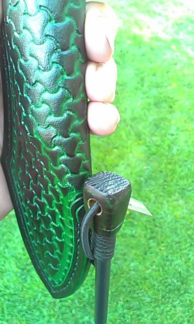

Chris, you got a pic of the side on the bend? I'm not sure how you do the bottom of the bend. I'm not sure how anyone does it actually, but at the bottom of the bend I punch a somewhat large hole (roughly twice the thickness of the leather if that makes sense) and trim some leather from the edges to keep the leather from bunching or puckering at the bend (by the stitching). That may not make sense at all reading it back... I'll see if I have a pic.
Edit- rats. I lost all my pictures with the new phone. This is a pretty crappy example because the ferro rod is in the way. If you look you can see how the groove kind of circles the round punched hole at the bottom of the bend. If you make the hole twice the thickness of the leather it will fold nicely.
This is not to say that yours isn't excellent or perfect. For all I know you are doing it better or even the same. Just passing along what has worked for me after trying a few things.
Dave, I've always stamped and grooved across the bend. I have seen some crazing on thinner, possibly stiffer leather. I'm glad you brought it up. May need to try patterning the stamping out of the bend. I haven't seen or heard of any problems from customers but who doesn't want to offer the very best in longevity? Thanks for the constant learning opps. :)
Edit- I guess the above pic also shows how I've been stamping and grooving across the bend. I wouldn't send out a bend that wasn't what I thought would be of good quality but I really have no idea how it works after years of use. May be a good lesson here for all of us new makers.

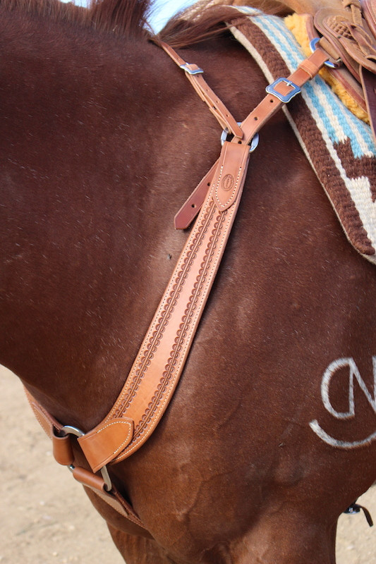

Lots of good info in this thread. Found a couple of pics that illustrate the strap sewing question.
If you look at how the D rings are attached on this martingale, both the one up by the shoulder and the larger one down on the chest and how they are attached. I think this is the question that Ken had about the belt loop attachment on Chris' sheath. These d rings take a lot of pressure. The idea behind a martingale is that it stablizes the saddle either climbing steep hills or while roping. I never stitch across this attachment. I've made probably a hundred of these martingales and I've never had one of these attachments fail. I've had em used till the leather was wore out but the attachments didn't fail. This method of stitiching is very strong.
