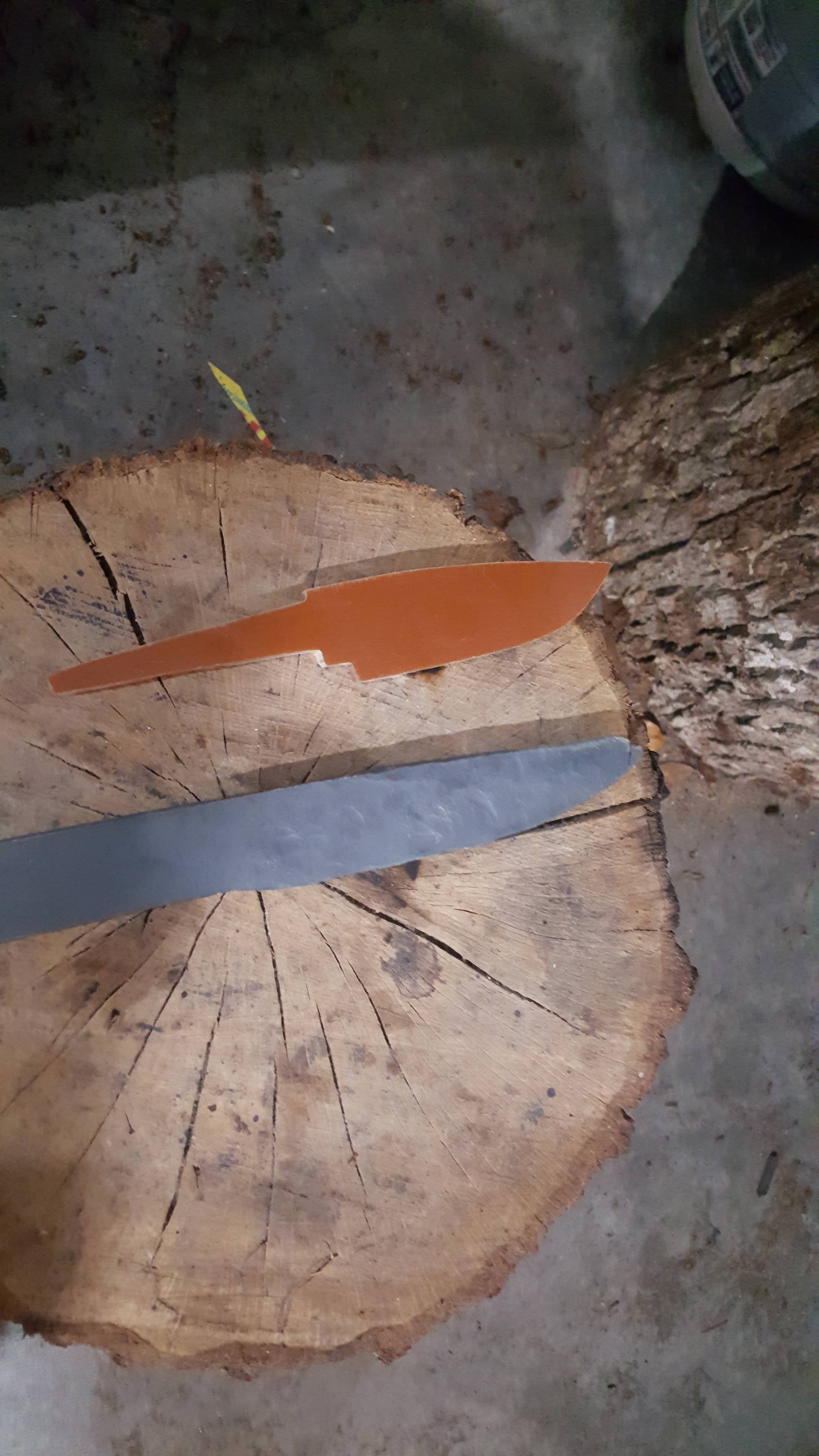

Well i watched a @Rick Marchand youtube video last night on forging and hammer technique. Improved my results greatly.
So thanks rick. Aside from the fishlips i have going on What are some other tips you hammer heads have? Thanks gents.
Grind off the fish mouth so you don't end up with any cold shuts in your work. When you start with a new bar of steel. Start by knocking the corners in. This will help you avoid the fish mouths. Next, while the bar is still all one thickness, make a pre-form. This looks like an upside down blade. The side that will be your spine is curved down. As you start forging in the bevels, that side will expand or get longer making the opposite side (the spine) curve up. The pre-form anticipates this expansion. Keep going. You're doing fine.
Thanks marc for the advice. Ive had a heck of a time trying to preform that tip. I dont think its getting hot enough

Another tip is to make the tip a bit longer and much rounder than the final desired profile. The excess will be ground away in shaping. This helps prevents burning the tip during forging and ruining your blade.

Great point. I cut the corner off and it helped tremendously so ill probably keep doing it that way. Im still getting used to how the metal moves so its not pretty

looks good, you have some hammer mark depressions that you may want to smooth out
you can use a flatter or gentle taps with a flat side of the hammer
