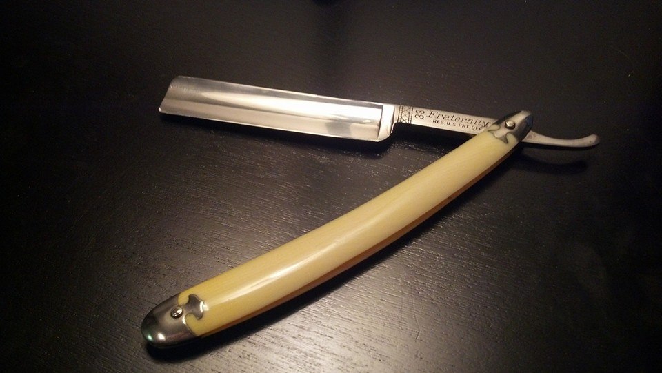

Apparently I must just be fantastic at sharpening.
I bought a straight razor (this make and model) for $20 from an antique store near me.
Sharped it myself on a Shun DM0600 combo whetstone (1000/6000 grits).
Stropped on a compound loaded strop (Bark River White compound on a DLT thin leather strop).
Have been shaving with it for about 9 months, with no issues once I got my soap/brush situation squared away. I strop it 5 times per side before shaving, and it is a perfect mirror edge every time. I really don't understand what the fuss is about with all this "minimum four stones" and "you can't do it yourself, send it to a 'honemeister'."

Yes, you did get lucky but a lot beginners can't take an antique store razor in their normal awful condition at the $20 level and get it to look like the linked example and hone it to shave ready. Also past experience sharpening knives may have some benefit but honing a razor is a bit different from what I can tell.
Near as I can tell a good condition shave ready vintage razor normally runs $50-$80 range from the BST on dedicated razor forums. A decent new stop likely $60 or there abouts. Then there is the actual act of stropping and there again as stated previously most beginners manager to cut or nick them learning how to strop. So you learn strop repair if it is salvageable and also likely have to re hone the razor damaged when you nicked/cut the strop. Soap and a brush can be the least expensive items on the list as a good $10 boar brush once broken in and a stick of Arko will do nicely. Still, that is in your dollar ballpark but does not include any hones. That could easily put it over the $200 closer to $250 or more depending on the hones selected. Not a cheap hobby to start from square one with.

I suppose my sharpening skills were greater than I gave myself credit for.
That said, I must have gotten lucky with my razor. It had some minor tarnishing that I polished out by hand, and that was it.
Now that I'm on my other computer, here is my personal razor:

Yea, for just a little tarnish and some hand polishing she was in pretty good condition to start with especially at that price point. Nice find looks barely used. I have heard people say that with vintage NOS razors they have stropped them and shave, no touch up honing needed. It just might be that factory edges were much better back then than they are now.
The real fun starts trying to get one honed up that has issues like chips, uneven grind or a twist so it won't lay flat on the hones. If you are really lucky you get multiple flaws in one razor. All kinds of fun to be had and the flaws are not confined to used razors, new production razors have been known to have flaws too.
