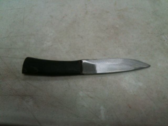

Got it today... overall length right around 18.5" @ 35oz:eek: wow heavy duty blade... handle finishing karda is not quite what I was expecting but acceptable. The karda looks like it was ground too hot and the edge is very ragged/bent over in places. also the kukris tip and a bit of the belly weren't sharpened all the way( have flat spots). note that this was received from another bf member and I don't know if it was sold as a blem originally. I am very happy with the sale and satisfied with my purchase. looking forward to using it. from what the seller said and so far as I can tell it was never sharpened or used in any way at all. thanks all for humoring me so far. I will try to post up some pictures later.

Karda

I can't tell much from your photos, but it should be easy to touch up the flat spot on the khukuri or the ragged edge on the karda with sandpaper and/or a small file. The steel will be pretty soft except at the edge near the belly of the main blade.
Just be careful. I would tape the edge of the blade except where you are working, and make sure always to rub the steel from the side toward the edge or point, so it doesn't catch you. Maybe use a bit of oil while sanding.
Karda is cleaning up ok so far. Worke off a killer burr still not super sharp but does have an edge which is all one could ask for. Who doesn't like sharpening anyway lol.

Ah thanks for the info. Can understand that as i am often at work while on the forum as well... Will be sharpening it at some point this week. The karda is now quite sharp. The chakma works very well for removing a stubborn burr. No testin of the kukri yet but hopefully soon

A couple years ago it wasn't uncommon to see khuks arrive with imperfect edges. There are times when HI (and Tora, etc.) has kami trouble/power outages and such. The good news is Tirtha was a good kami and the edge is at it's best after some sharpenings anyway. Just jump in and be careful. Khuks aren't hard to sharpen using various methods. Kardas and chakmas are always a roll of the dice as they are made by apprentices. The karda that came with my WWII was obligatory and sort of ornamental, but the one with my ASTK was fantastic. Those Deradun khuks were made for a while and were pretty much an HI M43 with an angled shoulder as opposed to the M43's curved shoulder. Should be a great chopper and they were quite popular when in production. If you wanted a heavy duty khukuri, that was a good snag:thumbup:
