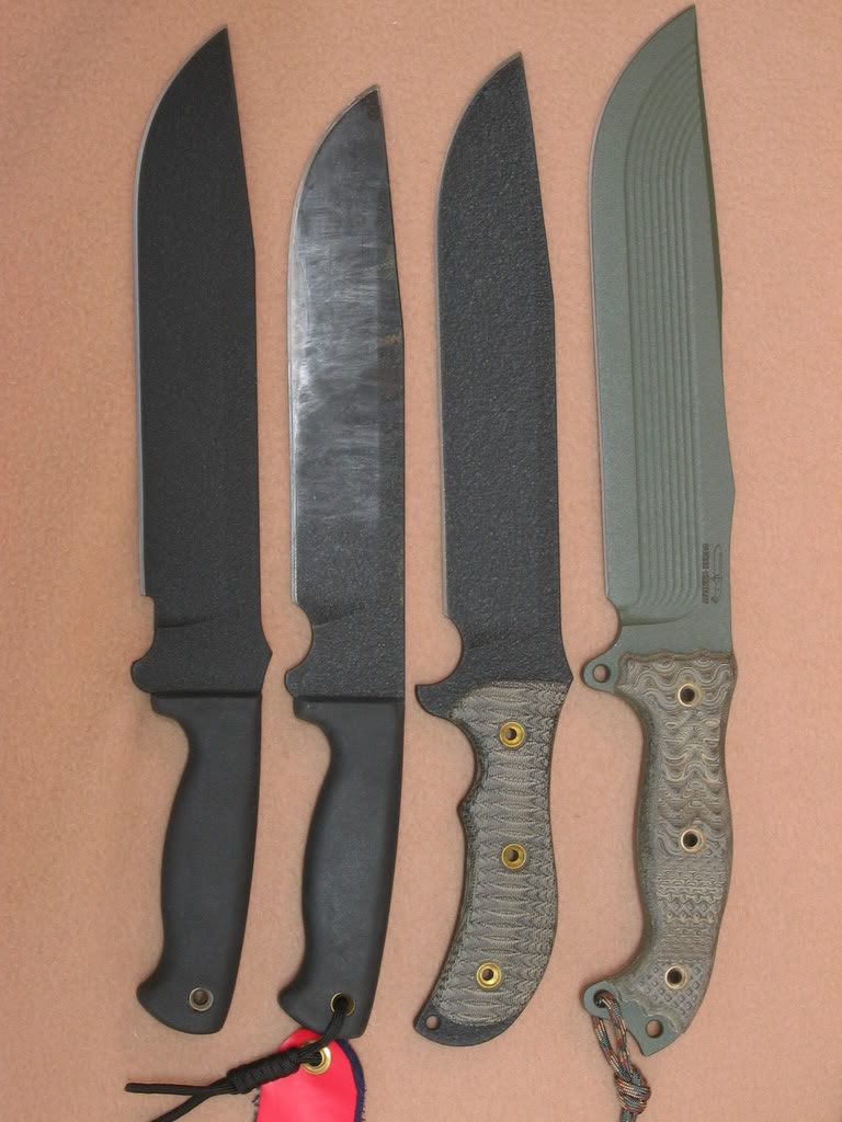

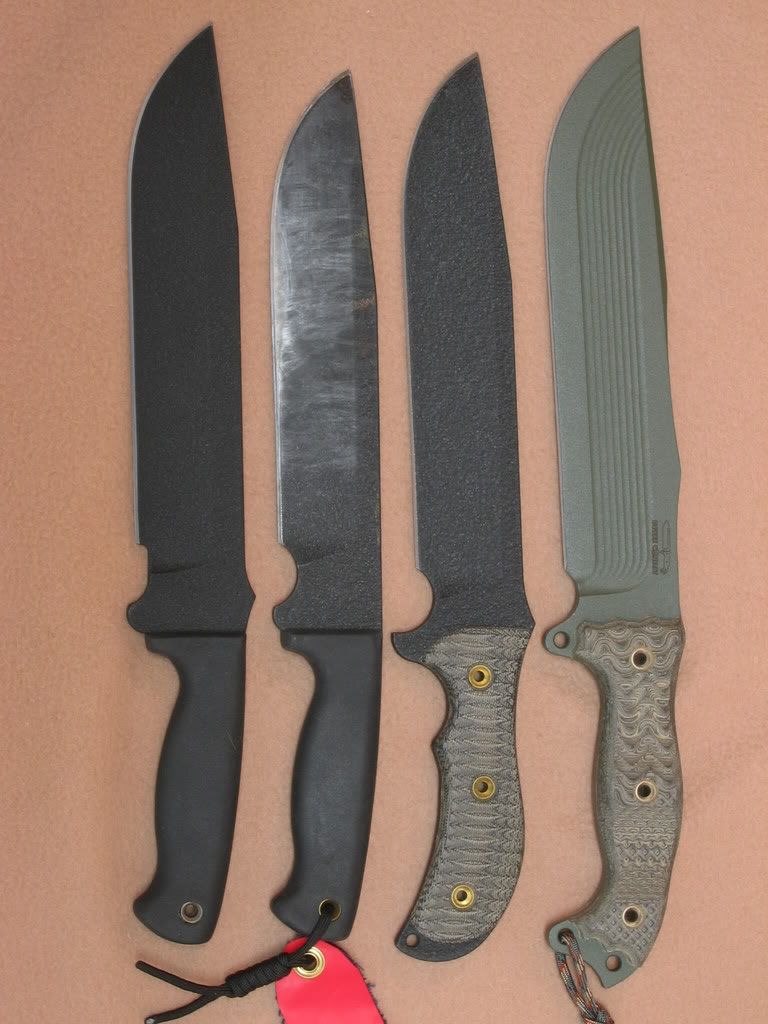

Well, I don't have a Rat Daddy, so I threw in my Mastiff for giggles. I tried to line up the front of the handles in the first pic, and the rear of the knife in the second. Didn't turn out to be much difference. Oh, well...
Oh, yeah - can you tell I like my BR, too? :D
those are great shots Greg.. can really see the relative sizes of all those bad boys.
thanks for posting pics.
