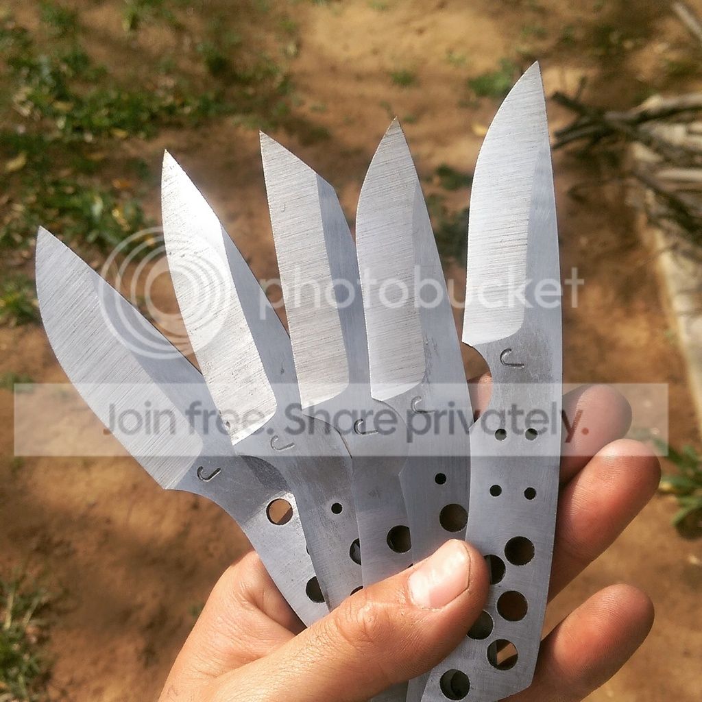

In my experience a chamfer, even a slight one, has a noticeable effect on the curvature of my plunges. When I first started on my 1x30 and even my 1x42 both platens had soft edges and I always seemed to get nice curved plunges with really no effort at all. Moving to my 2x42 and 2x72 that utilized platens with very sharp shoulders resulted in very sharp plunges. Took me a while to understand what was going on but I am positive the platen shoulders are the culprit. I have heard a lot of other makers talk about riding the belt off the platen and sweeping things in and while that works, I personally prefer to make things easier for myself. In my experience riding the belt off is a bit inconsistent and, at least for myself, is difficult to really know how much the belt is cutting. I have yet to radius my current platen but will doing so in the very near future. These blades below were all ground on a 1x30 about two years ago before I really started to have an affection for curved plunge lines. Basically, I wasn't trying to get the curves, the grinder did the work. Hope that helps a little.
Blessings,
Joshua
