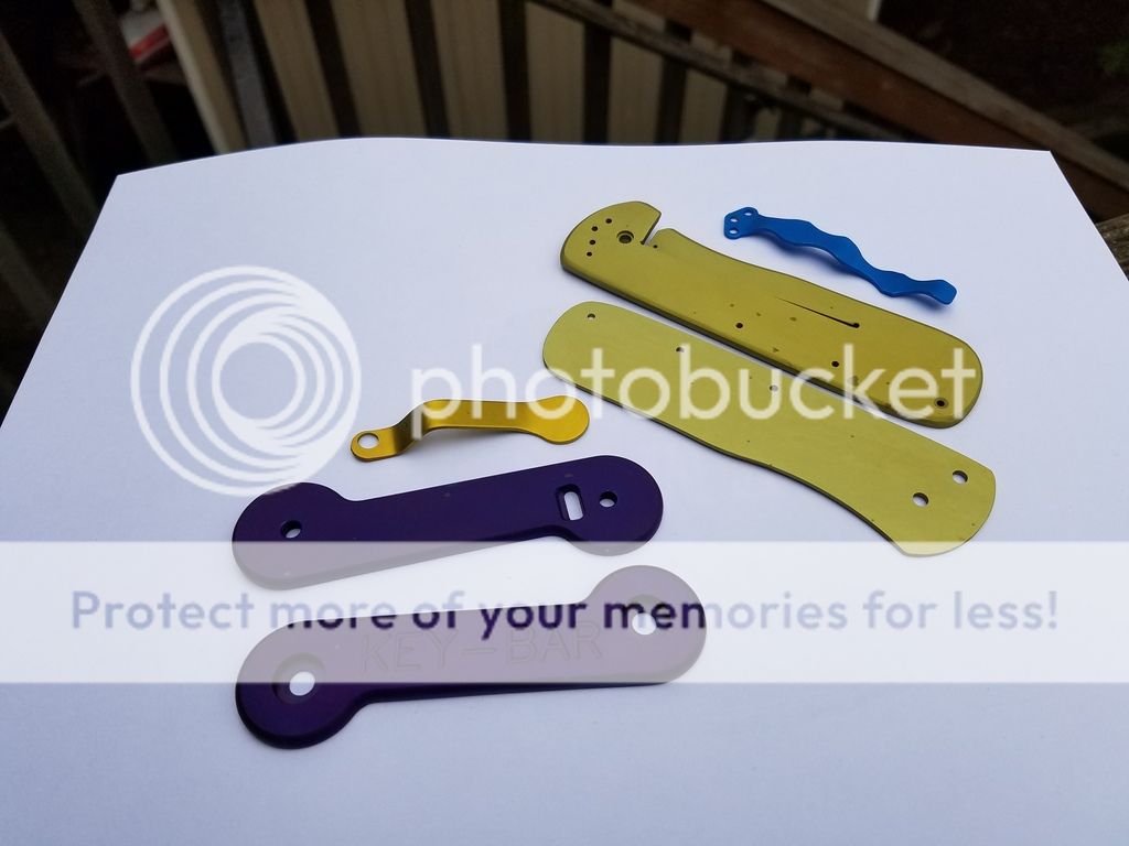

At anodizing that is... finally got my setup dialed in. Knocked these out today and I'm pretty happy with how they turned out. The spots on the knife scale are from the rain (gotta love the Pacific Northwest). I may start offering this as a service here in the near future.

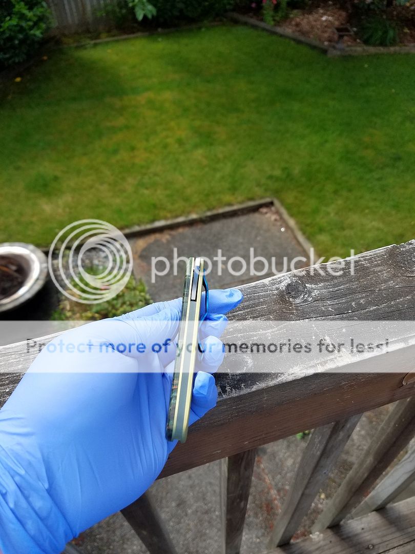

I have always wanted to learn how to anodize. Looks good. Save for the spots. Why did rain get on these ?
The reason I ask about the rain is if I ever get into anodizing, I live in the pacific northwest as well, Oregon gets rain. Although I would prefer to do it indoors if possible.

The rain got on them because I was taking pictures outside so I would have better lighting. Once the titanium dries it's a non-issue (as you can see in the assembled pics of the knife and keybar).
Ahh, ok, the way it sounded and looked was that rain got on them before anodizing and somehow caused the spotting to occur :P

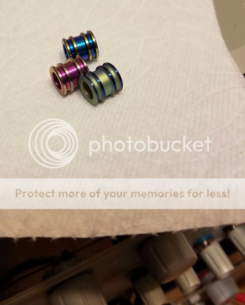

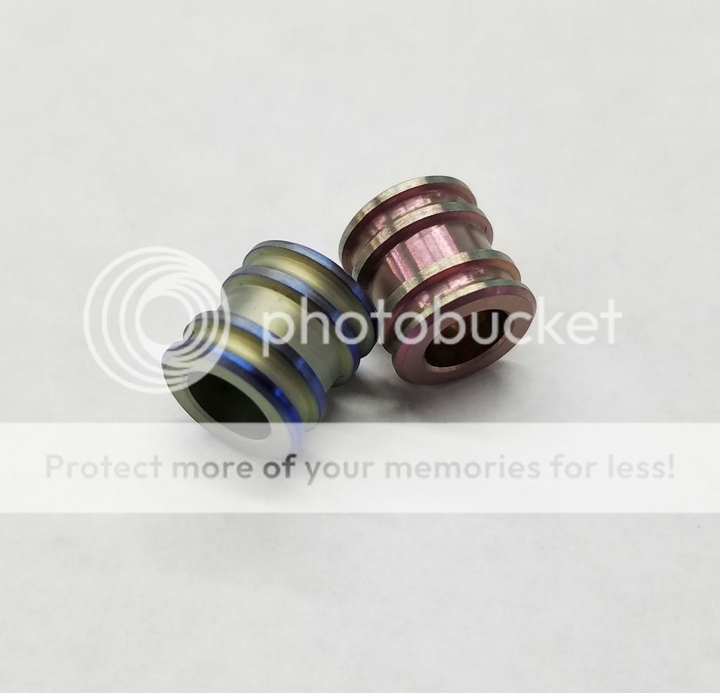

It's titanium. Anodizing titanium is accomplished by varying the voltage between 10-150 volts DC while submerging the titanium in an electrolyte solution. The pieces above were acid etched before anodizing so that the colors would come out consistent and vibrant.
Oh yeah. I can do the high voltage colors now. These will be for a GAW on here and Instagram when I'm finished with them.

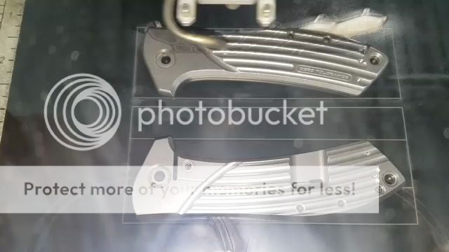

Question for anyone in thread who knows this. Can you laser engrave anodized titanium with a laser engraver that can not engrave into steel only the coating?
The knife above was done with a Co2 laser engraver
