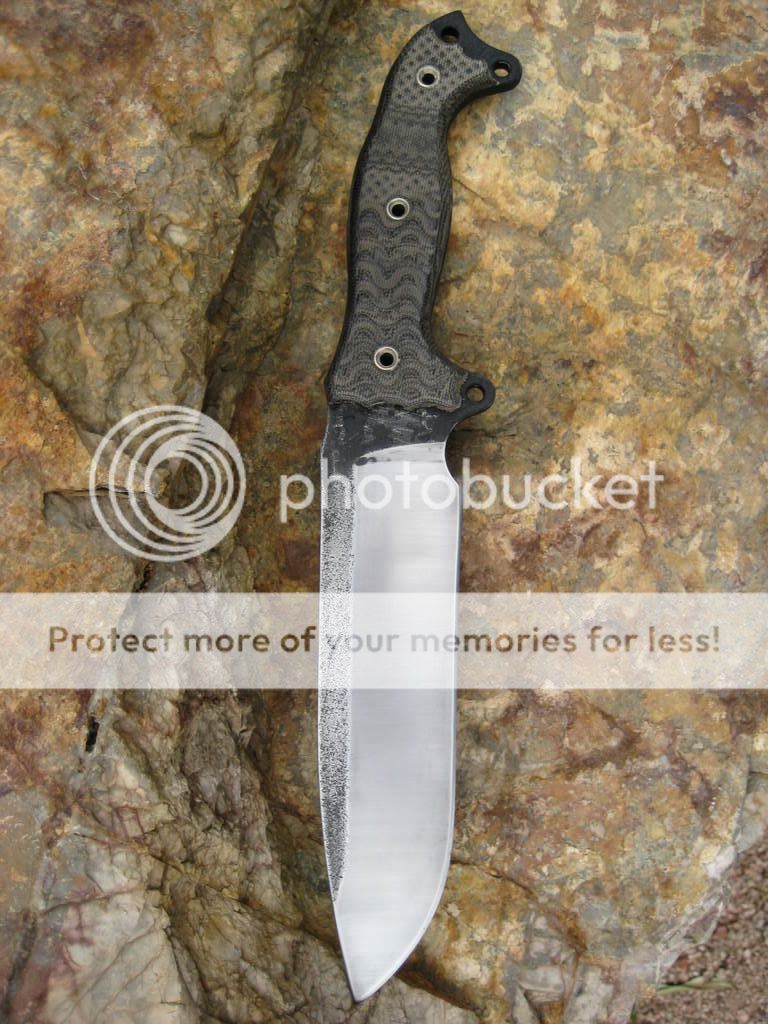

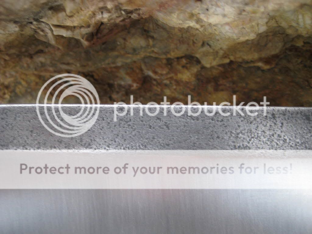

So I am stripping my HH. I had to remove most of the coating by hand because the paint stripper I used sucks! :mad::thumbdn: Any way, I got everything else stripped nicely, except for dimples at the top of the knife. I am doing this all by hand. (sandpaper)

I just did a Meaner that had sage paint on it. I ended up taking the scales off and using a disk sander. The blade was .190 when i started and now it is about .170. I had dimples and machineing marks. If you aren't careful when you sand you will leave high and low places on it. You might be better off learning to like the dimples and just satin over the top of it.

I am not too surprised about that at all. It really all depends on how deep those dimple and machining marks are...Luck of the draw! On the really shallow ones .015 removal is all that is required. The deeper ones sometimes require about .03 to remove them.
Here are some pics-

Gerber, I've stripped a few, and I found that the hand method v. machine method has zero difference for end results, but major for time/energy. I've used those sanding discs, but you need several grits cuz the lower ones cut into the steel then have to be smoothed.
My favorite method after trying many is the Scrotchbrite stripping attachments for a drill. The black plastic one will get those dimples down in under 5 minutes per side. Then the brown fiber one will give it a pretty good satin finish. Ham Solo (Tyrkson Lawson) is the one who I first heard mention it, and you can see from any of the projects he's posted the finished result is great. Check this out:

Thanks! Ham boy did a good job on that ASH! When I went to Ace, I could not find the drill attachment he was using, so I just picked up some sandpaper instead. I dont want to get rid of the little flats. It'll probably be finished by next week, and I will post pics, and will probably just end up leaving the dimples on.
