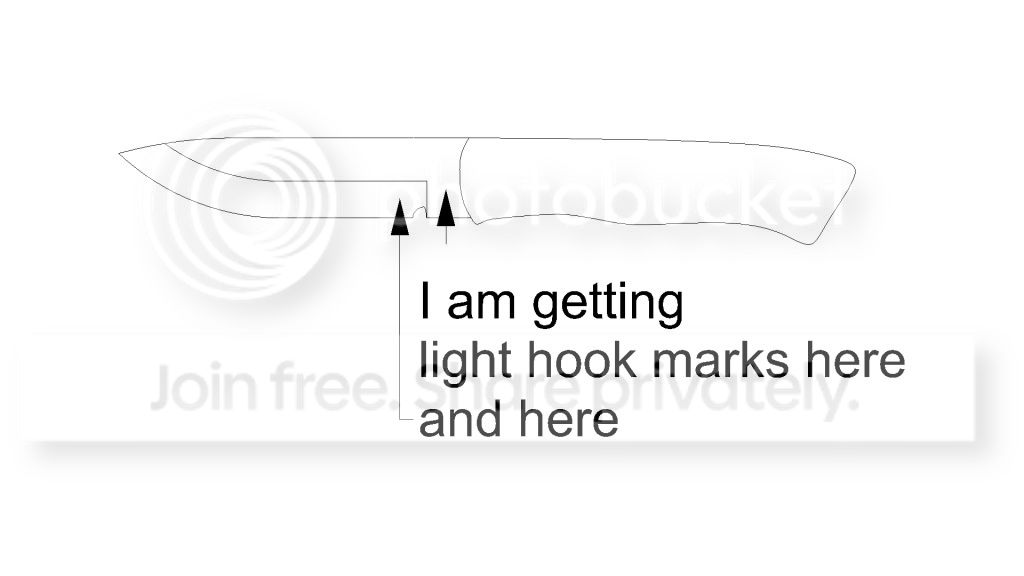

I know that he really liked the two bushcraft style knives I made, so I thought I might make him one. Thing is if I am going to do it I want it to be perfect, and I still can't seem to get the perfect polish on a blade. No mater how hard I try I still get little fish hook like smudges near the ricoso and plunge line. Is there some trick I am missing? I only sand in one direction per grit, either north south or east west, I arrange it so that my highest grit (2500) is run from from butt to tip, and I use a mixture of dish soap and water for the wet part of my wet sanding. Any help here would be greatly appreciated.

Guess I should have mentioned that the marks are showing after buffing, so I am guessing that my problem is in the sanding. That or my buffing wheel or compound is wrong. I have a loose linen wheel and have been trying green AO (0.5 micron) compound. Every knife I have made to date has the same problem
Are you finishing the blade before or after assembly? The fishhooks you are seeing is because you have to change directions in that area thus creating the hooks. If you do not get this area fully with the next lower grit it will not come out with buffing. You need a tool that will contact the area fully. I normally finish the blade fully before I assemble the knife. This will make it easier to finish the ricasso with no fishhooks. Just do not change directions on the ricasso. The choil area is a little more difficult. You have to start in the choil and pull out in one smooth motion. It take a lot of practice but can be done. Just make sure the previous scratches are removed before moving on. The motor oil, windex, wd40, or water is not a cure all. They provide a little lube that makes the paper last a little longer but you still have to make sure you do not change directions mid stroke.

I am getting a mirror polish by hand in every other spot but just out side the plunge and a touch up on the ricoso. My sanding stick is a piece of scrap brass if that makes a difference.
These are the exact locations of my marks, if that helps diagnose my problem

My experience has been the fish hooks appear at the back edge of your sanding block, this has happend with me on the back stroke. I start at the ricasso and pull toward me all the way off the blade. Just for the last couple of grits. A light oil such as mobil 1 does seem to help but the problem is most likely a slight change in the paper when you pull back.

I start one way sanding as soon as I get the scale off the blade when it comes back from HT. There is never that much so it doesn't take long to get it off. I think I ma going to have to make myself a few new sanding blocks to try and get rid of some of the drag and narrow the area I am sanding at one time. My current brass block is about 1/2" wide so maybe id I chamfer the edge and stand it up so that only about 1/8" is touching the steel instead of 1/2"

When I do a hand rubbed finish I use a piece of stainless about 3/4 wide and 3/8 thick with bicycle hand grips for comfort. If the sanding block is to narrow you will not get a good flat surface on your blades. To narrow and it follows the highs and lows. The key to inspecting between grits to make sure you are getting out the deeper scratches is good light. I use a goose neck light with a 50 watt halogen bulb. The bright white light makes the scratches show up much better so you can clean them up. I even use a magnifier for the last inspection. You will be amazed at the difference with the halogen light. The hard sanding block is good until the last sanding when I have found that a medium hard rubber layer on a steel bar gets to the last scratches better. You may be getting the fish hooks from the back edge of the sanding block when it hits the end of the blade bevel. I have learned to tilt the back edge up just before you reach the end of the stroke and then lower it back just after you begin the return stroke. I sand on both the push and pull. Also If you do not wear glasses you should try some cheap reading glasses in a +1.5 or 2.0 just for the inspection. You can pick them up cheap at any Walmart type store. For the buffing you are on your own. The pink no scratch seems to go good after the green chrome. I just use soapy water but have tried WD-40 and Cool Tool. I will try the Mobil 1 soon.
