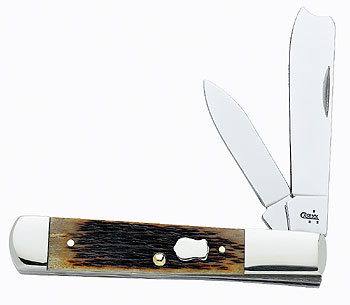

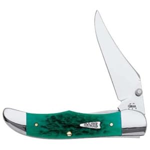

Case made a "mid-folding hunter". It is not currently in production, but you might find a dealer with stock.
Case also has the 'TrapperLock' pattern #6154L (thumbstud & liner lock, on a trapper pattern).

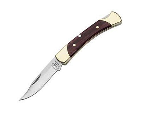

Some good ideas so far. I would also suggest looking at a Buck 55. It is small and pocketable and should be easy enough to pinch open, as long as he can work the lockback.
