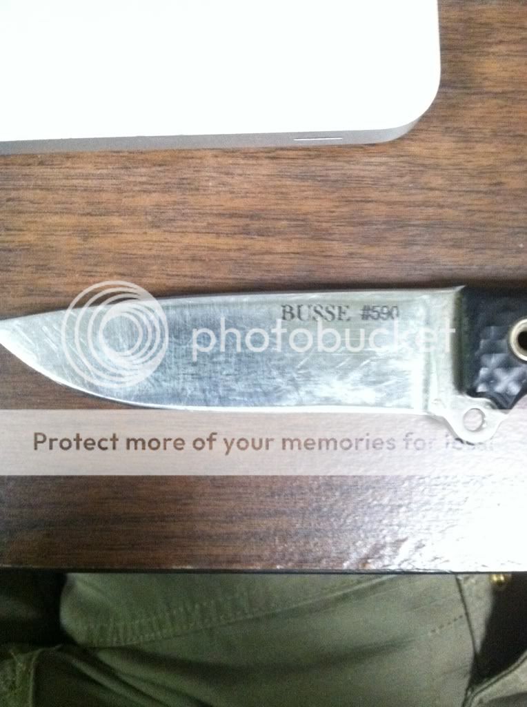

Here is my CABS. It has been used in a mashed cat kydex sheath. There is markings on it from the sheath, but I look at it that edc items should be able to handle the abuse and cosmetics doesn't mater. I like how I can pull it out and put it back in very easily with out straps.
I have had to sharpen it a few times already, but when you are cutting through mud, rocks, and roots, it is going to dull.
