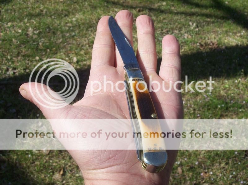

i got one, i wanted one for awhile and when i got a promotion (and raise) i picked me up one. Now i thought long and hard about whether to make a new post or post this here since its a trapper post (if you like i can delete and/or make a new post).
But i wanted to say, i dont care for it, at least not the way i thought i would. when i have the clip blade out and am bearing down on it, i can FEEL the spey blade depress and its just weird. My mini-trappers didnt do that, or at least not so i could notice, but the full size trapper does and its just not all that comfortable (not to imply its UNCOMFORTABLE ..just bugs me). Does anyone else have that experience or am i just weird?

I don't mind the pics Rsmith_77! the more the better.
