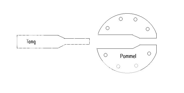

D. Crawford, i really like the simple elegance of your gladius. is the pommel welded on or threaded?
Thanks very much. Neither welded or threaded. I've had several inquiries about how I mounted the pommel so rather than type a long description, here's a pic.
The tang has "shoulders" near the end so I formed the middle layer of the pommel to ride on those shoulders. This way I could anneal & peen the tang without
stressing & cracking the handle material. Hope this helps.
