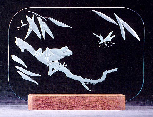

Thanks very much for the response Daniel, you make some very interesting knives. I'm afraid that I couldn't find any examples of what I'm looking for however.
I'm searching for a combination of high polish and a blasted matte finish on a metal handle. Something where someone has created a pattern or design in the handle.
The art form of glass blasting (etching) as shown in the photo below, but on a much smaller (and simpler) scale... and on metal.

There are lots of ways to mask a part to be blasted. A pattern cut from vinyl adhesive sheet and applied to the part is one of the best, as the vinyl can be trimmed to a very tight and complex pattern, shape, design, sceen... what have you.
The vinyl sheet is extremely durable and will take quite a bit of blast abuse and still produce a very fine edge separation, while the adhesive is high tack yet easy to remove.
I usually use clear so I can get a better idea of adhesion.
The only downside is that it can be difficult to apply to compound curves without using a 'float' liquid and a heat gun. A good alternative is to use multiple overlapping pieces where required.
Where do you get such a product you ask? Easy, it's what's used as a protective number or decal overlay on a competition motorcycle.
Go to any dirt bike dealer and ask for a clear number plate 'simple sheet'... about $12 for a 18"X24" sheet.
C

A few other glass beading tricks...
Always shoot perpendicular to the subject surface... as squarely as possible for a sharp crisp edge. By working at a greater than 90 degree angle across the vinyl, you can produce a blast 'shadow'.
If you want a 'softer' edge, hold the subject or the gun at a slightly less than 90 degree angle.
This is another nice bonus of using clear vinyl... you can 'see' just how soft the edge gets as you go.
Better to use low pressure than high... your not removing contamination, only texturing the surface, and it's easier to 'layer' in that texture a bit at a time than to try and get it in one pass.
Have fun with it... a bit of experimentation on scrap will help to guide your hand when you do the real thing.
