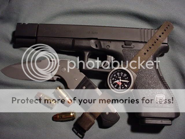

I had a G21 that I did that conversion on, but I've since sold it. I can't remember the name of the company that made the barrel, I do know they've went out of business since then (it was around 1998 when I bought it). It was just a little longer than the stock length with a thread on compensator. Although the .400 CorBon has higher velocity it's also a lighter bullet, so I'm not sure if it puts more stress on the rest of the pistol or not. It's a bit hotter than the 10mm, but not too much. Felt recoil was less than the .45, but of course the compensator helped there. I did find this quote online "The 400 Corbon maintains the same chamber pressures as the 45 ACP +P"
With the 13 round magazines I could only load about 6 rounds, any more than that and it wouldn't feed reliably. What would happen is because the round is bottlenecked the front of the round didn't have enough support and would get caught on the feed ramp. A 10 round magazine could be filled and it would feed fine. If you search some pistol boards you'll see it seems to be a common problem with the Glock as the 13 rounder is a doublestack.
BTW, you can make this same conversion on a 1911. There should be no problem with feeding there as it uses a singlestack magazine. They do suggest you change the recoil spring to 20 lb on the 1911.

This is the only picture I have of it (the knife is an Andre DeVilliers)
