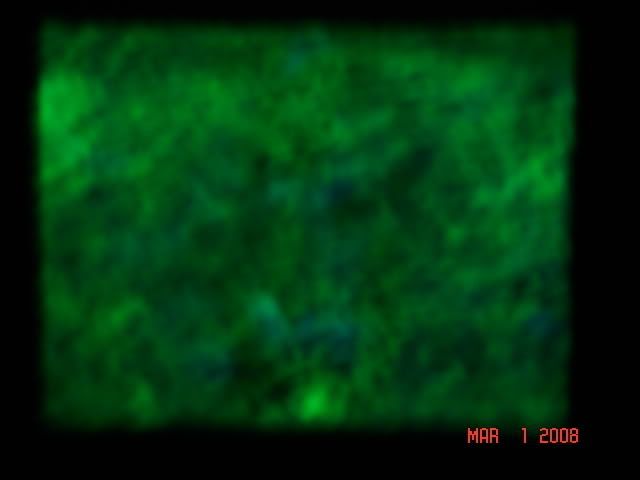

This is about as close as I got. Apparently my camera doesn't like the dark and they just looked like glowing blobs when I took some of the scales. This is the uncut slab that I set my SureFire on in a couple of places for just few seconds.

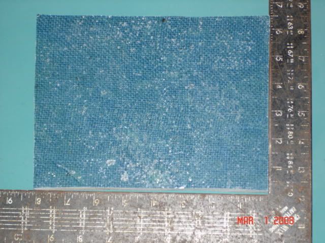

James, the burlap was blue and I added a good bit of ultra green V10 glow powder to it. The burlap works great with the glow powder, as the combination of open weave and coarse fibers allows the powder to "migrate" evenly as well as get trapped by the fibers. The lighter colors work best with the glow powder.
Here are some pics of the block I took before I sent it off to Eric:
Yup, green blob, that's what mine looked like too! Looks better in block form though :D
