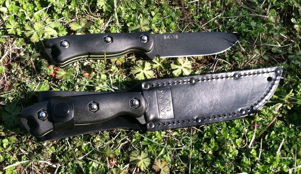

Yeah. Got it. I like the stainless bolts with cap nuts. If you check my thread above, I used the corby(I think) and cut just the threaded part off and used it with screws on both sides. The corby post fits exactly in the stock screw holes in the BK5 handle. Had to drill them out on the 15 and that was a bit of a chore not having a proper bit but the results are worth it.
Here's the cap screw look. If you do this make sure you get Home Despots because bLowes are really tall.
10-24x3/4" and 10-24 cap screws for the big beckers
8-32x3/4" and 8-32 cap screws for the tweeners
I use liners(another fun and easy project) so the 3/4 work and the cap screws hide the extra length and give it a finished look. Without liners I guess you'd need 1/2" for the tweener? Not sure because all of mine have liners and 3/4. I do know, however, without liners the 3/4 on the tweeners leave the scales loose. I think it's ok on the big scales because the stock ones are 5/8" I believe. But, once again. When I do the stainless upgrade I also make liners so I'm not 100%.
To countersink I just used a larger bit after drilling all the way thru with the same size as the screw hole. I'm pretty much a hack and just figure it out as I go along heh. I have no special equipment or bits except for a small cheap drill press my dad gave me when he moved. That's great for keeping stuff straight. Although I used a hand drill for the 14 scales.
None of its perfect but I'm doing it for me not for a customer and its good enough for a user. I like a little grungy and home made look anyway.
