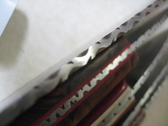

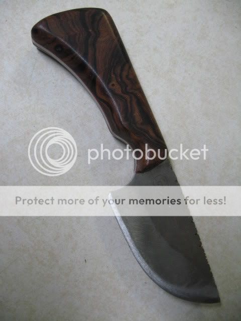

I used it quite successfully on my neck knife that I wore for my wedding. Six years old, no pins, has been in frozen temps, hunting, camping and kitchen duties. I've had more luck with it than acraglas actually, but I'm pretty sure I got a defective batch. From my research the glue only expands when not under clamping conditions (lots of space for expansion, not suitable for hidden tangs or holes in tangs), from what I broke apart after glue up on test samples there were no bubbles (not easy to split apart either), and I found the expanded glue to be very easy to clean up. There is much misinformation about this glue due to the expansion issue and I feel it gets unduly dismissed. Maybe not the best choice but I have had it work. This was actually a scrap of steel I tried my first file work on, and was on my third to seventh knife.
