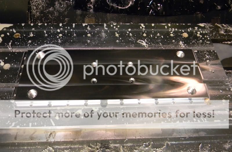

I machine off of adhesives all the time. There are parts I make where it is the only good way to achieve the results that I want. It is the only way to hold a part where you can cut 5 out of 6 sides without inducing stress into a large thin part. I make large aluminum plates that are machined truly flat. The fist side I use epoxy, then when I flip it over I can use vacuum.
Super glue works well, but it is slow to set inside the joint where it doesn't have access to moist air, which can leave you with less bond than you think. I like it because it can be wicked into a joint, but I like certain epoxy better because it is more reliable and has easier clean up.
My favorite epoxy for this is the big bottles of consumer grade 5 min loctite epoxy you can buy at places like Lowes. They cure fast, they're not gummy to machine, and they always have consistent, repeatable poor bond strength. The epoxy is rubberized so clean up consists of pealing it off your parts where its poor adhesion allows it to pull off cleanly. Kinda like a stick-it note.
(aside) you never want to use this grade of stuff for knife making, by the way...
I usually only use small cutters when profiling. If something does go wrong, an 1/8" cutter simply can not launch a part at highly dangerous speeds. In all my years of doing this, I've never had a part "launch" more than a few inches.
When milling the top surface of steel, you will induce stress into the skin of the part that will make it draw away from the cut. When you pop it off, it will not be straight. There are methods for dealing with this.
Don't think for a second that once square inch of bond is enough to stall a 3 HP spindle. The math aside, is simply isn't.
So, anyhoo, epoxied work piece being machined:
The mostly finished part
Machined on all five surfaces (this was all done very quickly, by the way)

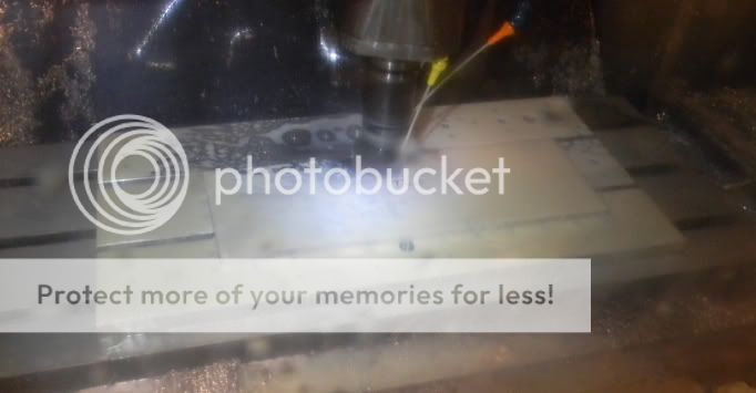

Oh I actually do routinely use a 3" face mill with just glue and take 5 HP cuts. With large glue surface area and inside a full enclosure. However I don't particularly recommend it.
So I made a gluing plate with some reliefs to aid in setting super glue across such a large area.
http://www.flickr.com/photos/98126710@N08/9143988731/
Glued a damascus billet to it and gave it a day to set up. Face milled it taking off about .002" per pass and was reasonably happy with the was most of it cut. Last time I tried milling it the lockup wasn't nearly as solid as the glue and it was skating and chattering. It is clear that there are places where the layers were not completely bonded though.
http://www.flickr.com/photos/98126710@N08/9146212682/

One BIG consideration in gluing things for milling/turning is the way the joint may fail. Double sided tape and super glue will hold things well if they will only get downward pressure or other direct stress. If the force will be a shearing force, Super glue may break away, but the tape will hold pretty well. If there will be heat built up in the milling/turning, then the super glue will fail quickly as it approaches about 200F. The tape will give away a little sooner.
Yeah, I built a cage around it while I was cutting in case it broke away. Was concerned about the temps since I was cutting more or less dry but the surface temp after passing over an area seemed not to have changed. Was throwing blue chips too so I expected noticeable warming but it was either bleeding heat off in the chips themselves or it was being conducted fast enough through the aluminum that I couldn't tell. My speeds and feeds were pretty modest anyway.
Did wonder in the glue vs tape if the tape would be better because of its tendency for ductile failure. Might give you more warning than the CA. I tried the flexible epoxy on a small scale but found it much harder to separate the pieces and remove the residue. The stuff I used set up fairly hard though, maybe I need to try the loctite that Nathan recommended.
