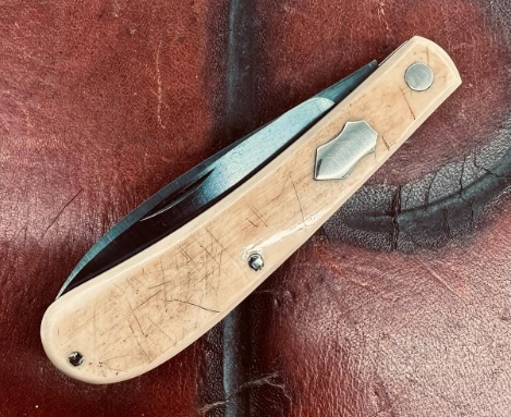

I have sourced some larger sets of bone scales from Culpepper in the past.
This is a Sonoran Camp Knife the largest standard knife model I make.
Anyhoo to answer your question on the bone supply and its the same with the hides. Its not worth the effort on a commercial scale. Most hides and most bones are simply destroyed or thrown away after slaughter. IF you wanted to process your own ya could contact a local slaughter company, a guy that travels around and puts down animals folks are raising, processing them into quarters for ya if a steer and then delivers the quarters to a butcher for ya. In all likely hood they'd just give ya some shin bones. Takes time to age and dry them and then process them into scales. I have done this on buffalo bones for special customers that have killed a buff and wanted a knife with a handle from their buff. Even when I receive the bone and it has been dried and you are working with a cured bone it is still a lot of work for very little return.
Here's a Buffalo:
I recently did a batch of knives for the same customer with antelope bones (shin bones btw are what is used). This too was a lot of work for a little result but like I said a special customer. He wanted one for each grandkid:
Again I was working with bones already dried and processed I was just cutting them up.
I have worked with a lot of goat horn in the past. Had access to quite a few horns from a local animal trader auctioneer. Its very much like sheephorn and again looking back and with the wisdom of age, probably not worth the effort.
Culpepper is the source for bone, or the dog treats. Cattle shin bone was used on most US pocket knives.
Camel bone is available.
Cow horn was sawn into spirals, heated, and pressed flat for knife handles in Sheffield.
Goat and sheep horn shrinks drastically for quite some time-years, maybe decades.

I've got some but haven't done it yet. I'm sharing and following the advise of Ken Coats. I feel like at this point I'm reasonably competent at making a slip joint pocket knife. I have on good account this and Ken's dying process are used by a few renowned makers. I mean at worst what are you out trying it vs. spending $15 for a single set of bleached bone that is too small for your needs from the mentioned supplier? ;)
