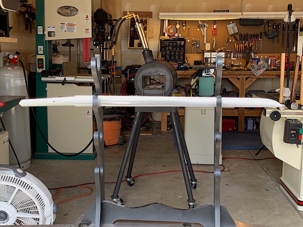

A hira-zukuri wakizashi
So, it’s shorter (20” cutting edge) and simpler (no shinogi ridge on the sides)
All going pretty well so far. Forged it from a 1 1/4” x 3/8” x 11” piece of 1095 using a 4 lb hammer for most of the drawing out, and a 2 1/2 lb hammer for forging the bevels.
It’s 98% ready for heat treatment. Broke my drill bit drilling the nakago, so I have to finish that yet, cut the machi notches and filed the ridge on mune today.
Now I have to fabricate some kind of trough for the quench. It’s too long for the bucket.
Like my chef knife, I’ll be doing an interrupted quench, first in water and finishing in parks 50.
This worked very well and produced a really nice hamon. I’m a touch more nervous about it though as I’ll be eyeballing the temp with magnet and color instead of the super accurate kiln I used for the knife, and 1095 is reputed to be picky so I’ll have to eyeball it right :-)

This wakizashi has an overall length of 26” and just fits in my oven
My puzzle for this blade was figuring out a quench tank.
I managed to put it together from parts I had laying around. I cut up and welded together some angle iron to make a frame for cheap plastic window box. The box itself isn’t strong enough to hold the water, but with the frame and a liner of 4 mil plastic it totally works...
My welding is the ugliest, but it’s good enough for this :-)
