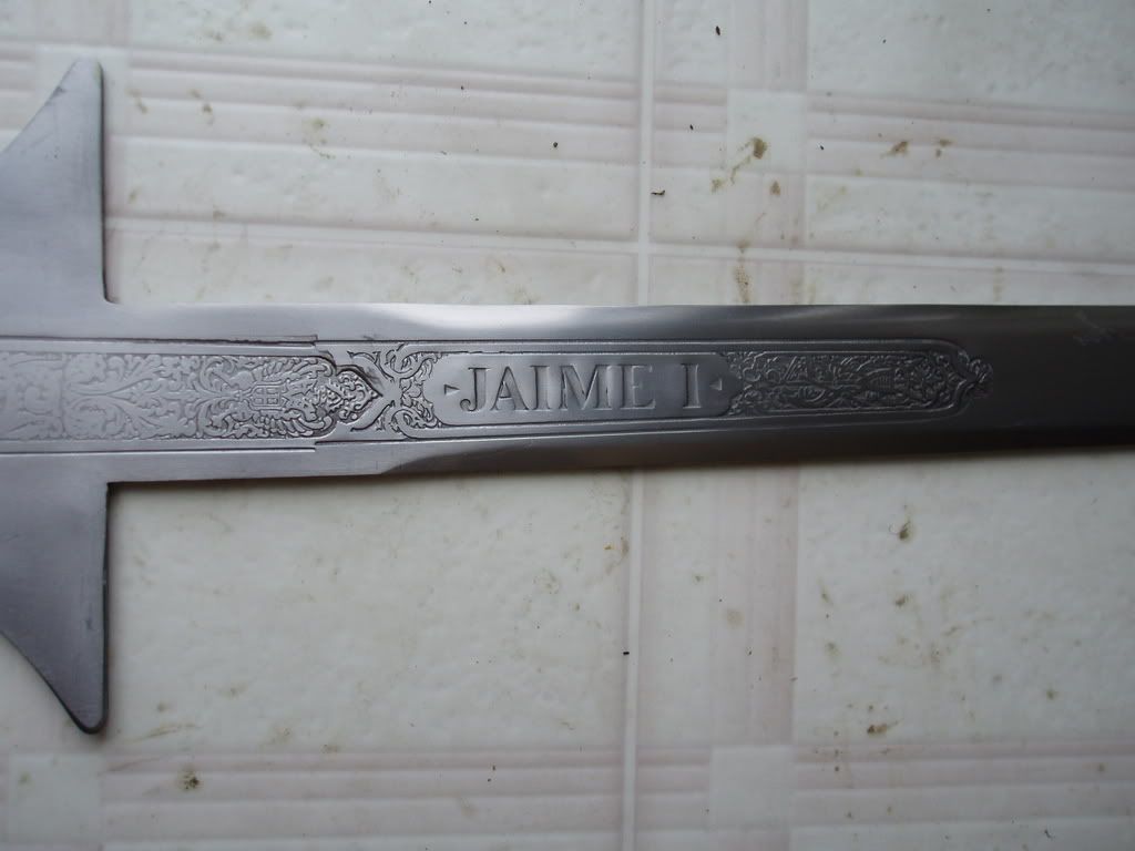

I believe I have 2, James I Battle Sword, Broadsword, Two Hands, "Battle-Ready" Length 52" Weight 4.4 Lbs This sword is 2-1/2 feet long, you need two hands!
http://www.collectibleswordsusa.com/James-I-Battle-Sword-SFT530-p-16320.html
Mine might look better than the current model because of the markings going down the blade (James 1 scrollwork, made in Toledo Spain)

They are maked James I. I don't know if they are the same or a different company, same design. I am not finding a lot that looks like them.
I remember other swords that were marked collectible and these were marked high carbon and there were suppose to be able to fight with these. Is there a way of telling if these are fighting swords or just wall hangers?
Well, the fact that they are rust free after sitting in a closet for years, unattended, lends credence to the steel being stainless. Not a good sign. (And stainless wallhangers are very often sold as functional, which is sad...)

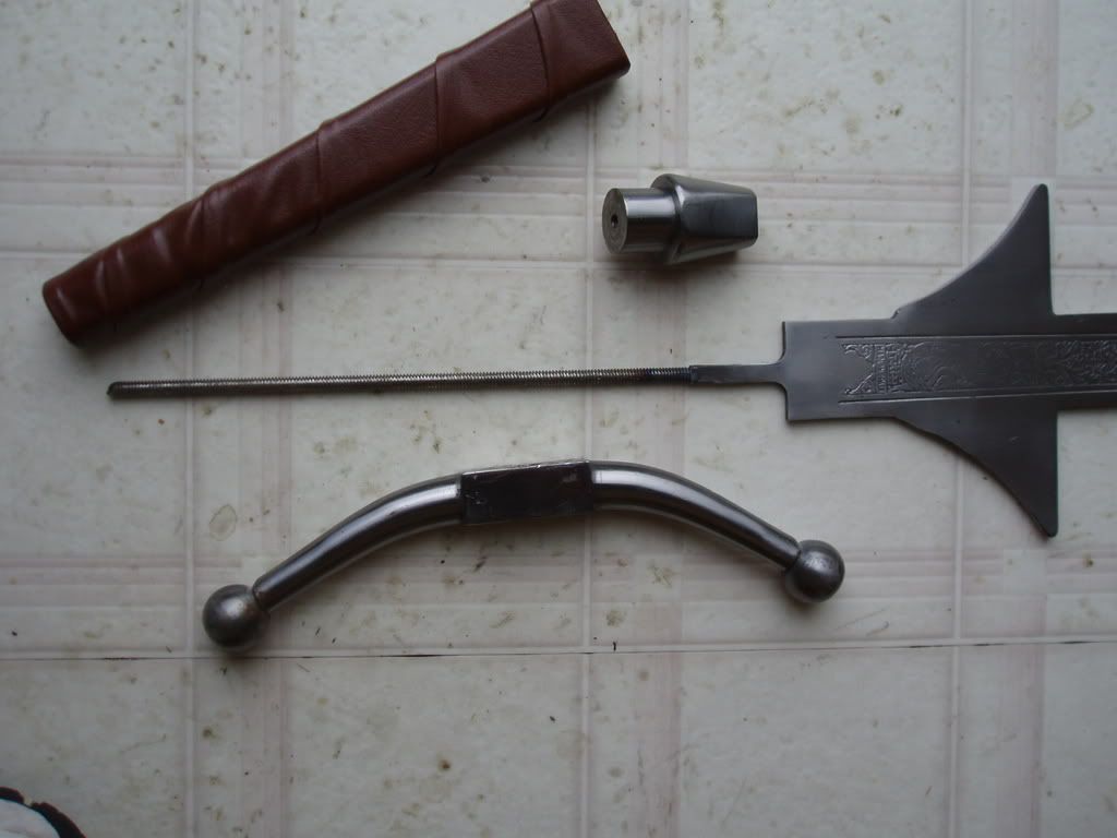

There's no safe way of proving the functionality of a sword of unknown origin. The testing required is potentially destructive.
If you can, take and post photos. If possible, see if you can remove the hilt(if the pommel or pommel-nut screws on... if the pommel is peened, it's not happening). Taking photos of the tang would help somewhat.

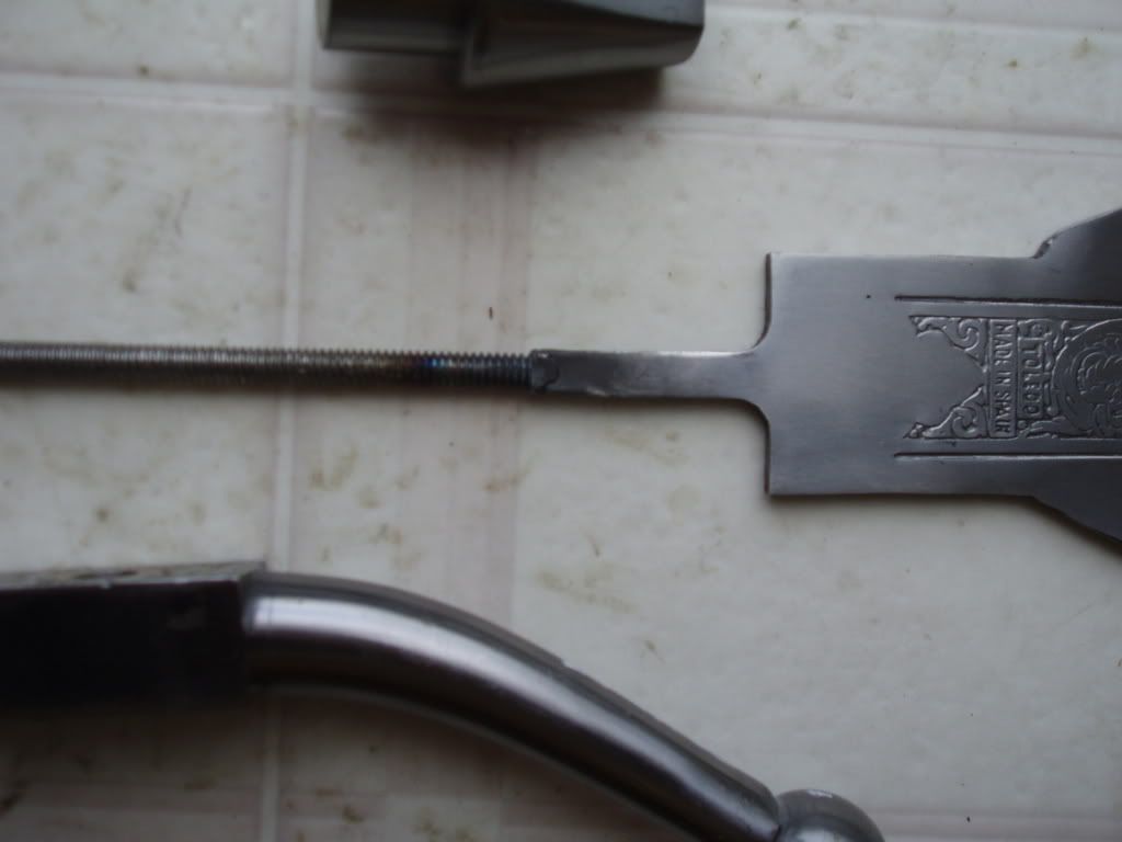

Take a photo of the tang.
It is too cold to do this outside. Main part of the house is too dark for this camera to get good details, but right by the back door, where I have tracked in stuff on my feet. Please ignore the dirty floor.
Definitely non-functional.
The tang is far too narrow at the shoulder. The threaded extension isn't welded on properly, and is also far too long. Wallhangers are made this way to make handle-manufacturing easier(only need to drill a hole as oppose to chisel and laminate, or drill and burn).
If these were sold to you under the pretense of being functional blades, you were screwed over. Even if the blade material is good, the tang construction is far too shoddy to support a functional blade.
If you want to move them cheap, I suggest posting them for sale on the SBG forum. If you charge less than $100, you can probably get rid of them as project blades which weill be butchered for their hilt parts, and maybe the blades shortened and experimented on. Other than that, they are wallhangers or costume pieces.
