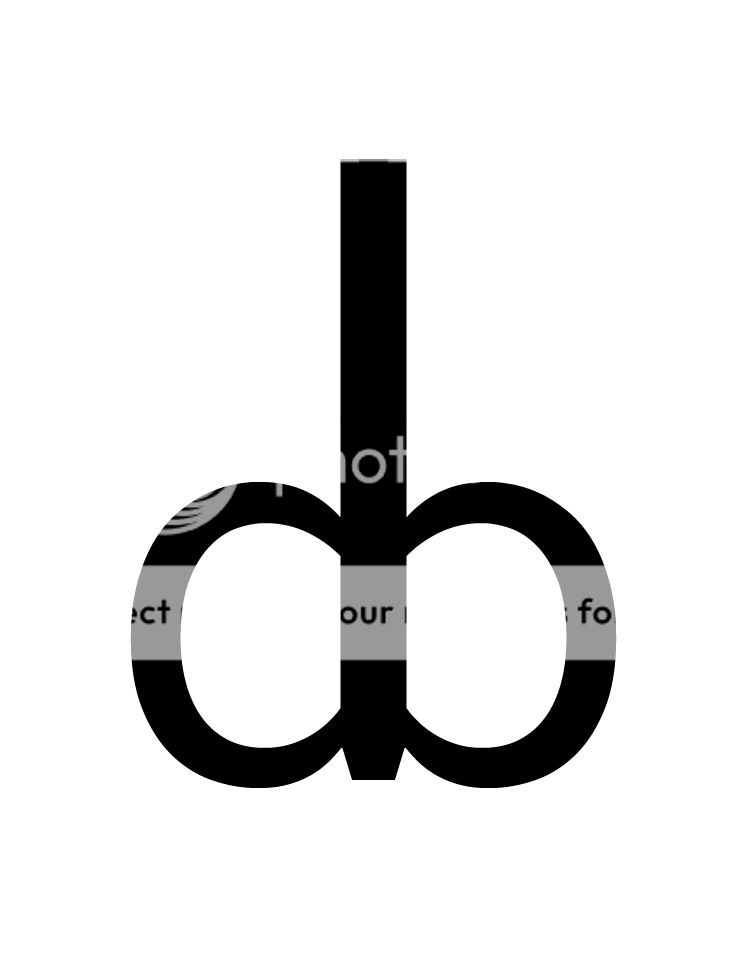

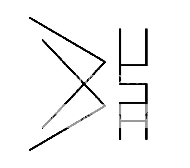

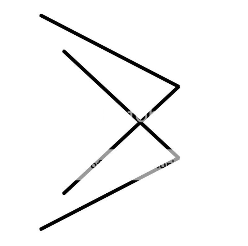

Its about time for me to order a makers mark stamp and I am not sure what size or what design would be ok for a metal stamp. This is what I have so far. I really want a DB for Dynamik Blades and I also want USA in there somewhere, but I may have to drop it and just go with my symbol for DB. This is what I came up with. What do you think.
I know it is hard to read but that is the point, I am going for a symbol style look.
This will be used for all my knives so I am unsure what size. 1 centimeter square? More or less? I just don't know.
Like it, dont like it, suggestions? This will be the first and hopefully only stamp that I buy.
The bottom one didn't make the cut for obvious reasons. :eek:
Thanks for any help.
If you hadnt told me that the second one was USA i never wouldve guessed it.
And the first one is supposed to be a db?
IMHO your designs are a bit overdesigned.
I´d like one that is instantly regonised for what it is.
I doubt if the letters will be regonised as letters when stamped in a blade
Much too busy. If you're going for a logo type design, it should be immediately recognizable. And you're right, the third one borders on the obscene.
Simple is better.
A plain block style DB is good. You can flip the "D" to make the letters back to back if you want fancy.
The maker's mark has to carry some sort of info about the maker, unless you plan on becoming a household name. A spider instantly says spyderco....but only because they spent millions promoting that ( and they still mark the blade SPYDERCO). If a small time maker had the nickname lizard, and used a lizard for his mark....no one would know but him.

Sure, being proud of our country and its military is good, but there is a lot of USA here, and a lot of DB's in it.

Now, if you put a logo like the ones you drew on one side, and an informative maker's mark the other, like:
D. Brown
OK City, OK
USA
Then you would really have it all. People would know the maker of your knife long after the maker was gone.
The way to do this, and make any combinations or changes desired, is to use an etcher and not a stamp. One good 24V etcher will last a lifetime. You can get the logo and maker's mark stencils made in a variety of sizes and mark as needed. You don't mark the blade until it is done, so there is no need to hot stamp and deal with grinding out the mark partially. Changing your logo or mark only requires getting some new stencils.

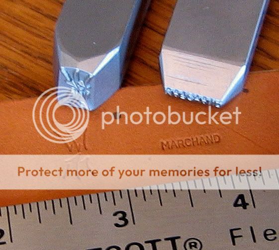

In defence of stamps... I have been using them since I started and my current ones (logo and "MARCHAND") have been in constant use for 4years without issue. I use them for metal and leather.

I stamp normalized blades, cold, prior to heat treat. Stamping hot with eventually temper your punch back. My stamps are from Henry Evers at Everstamp. 4yrs ago my logo was $210 and my name was $180.
I got 1/16" font for the name and 1/4" for the logo... and had them made separately so I can arrange them on even the smallest of blades.

Both of mine came from Evers as well, and I put mine in an arbour press after getting some double stamps on the first knives I tried it on. I decided to use a name on one side and my mark on the other. As I will probably be a hobbist for the next few decades it should be enough for me, I'm slow to build as I start working on knives around 10:30pm-1:00am if I have energy after the kids go to bed, so only a few knives per year, and my little grinder died on Sunday....
Here are my stamps
And my stamping setup.
I'm not good enough to stamp freehand. I don't care the most for the Evers stamp holder, but I work with what I have.
I too feel that the marks you chose are difficult to understand, but would make a nice second stamp.
