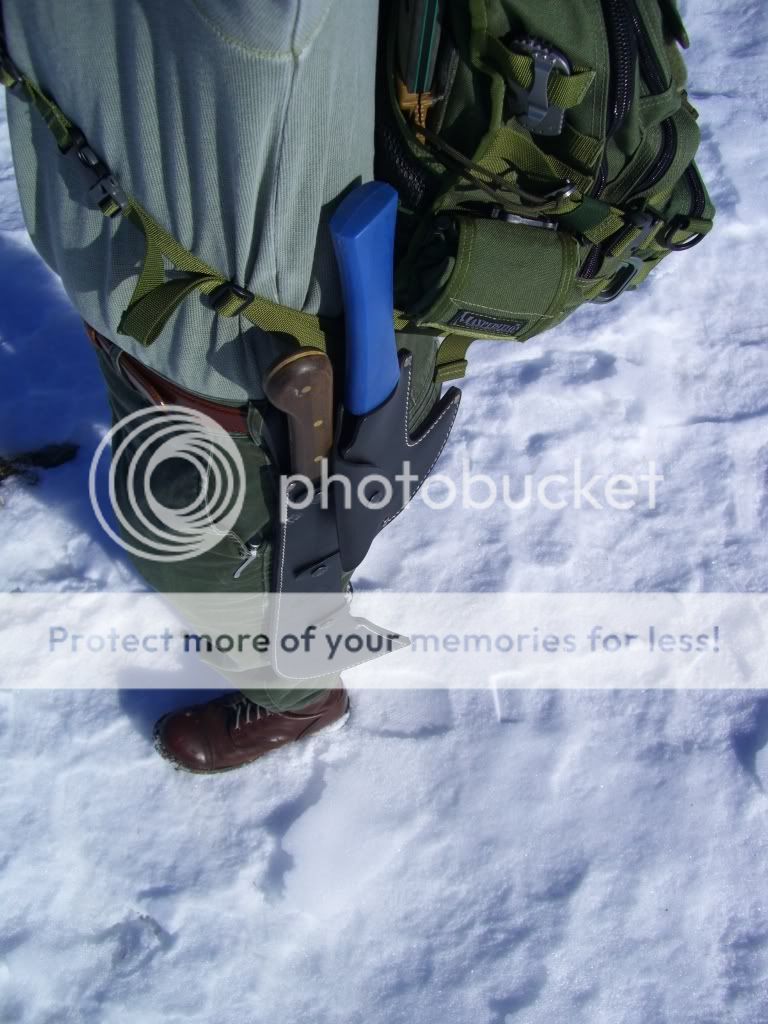

I don't have a dedicated suspension like this, but instead run the stabilization strap of my Maxpedition Lunada through the belt loop of my machete sheaths. If you don't have a swivel of some kind (like on a Condor sheath in my instance, or a ring or dangler in a custom sheath) then you'd want to affix the sheath at a slight cant so that you could comfortably draw.
Perhaps a little hard to read the image (because I was taking it myself while wearing the pack) but here are my Condor Viking and Bush Knife choppers on my stabilization strap. They're very comfortable there and don't get in the way.
