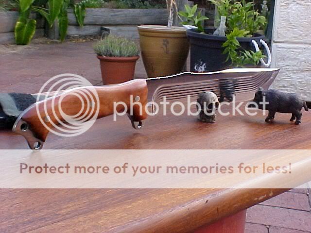

though i did see a post where the guy had a mirror finish on his cbt fbm. it was mighty awesome!
its all in the detailing he probably used a buffing wheel with cutting compound to remove scratch pattern to get to satin then
changed wheel and compound to finer polishing...its all about time and materials...good luck

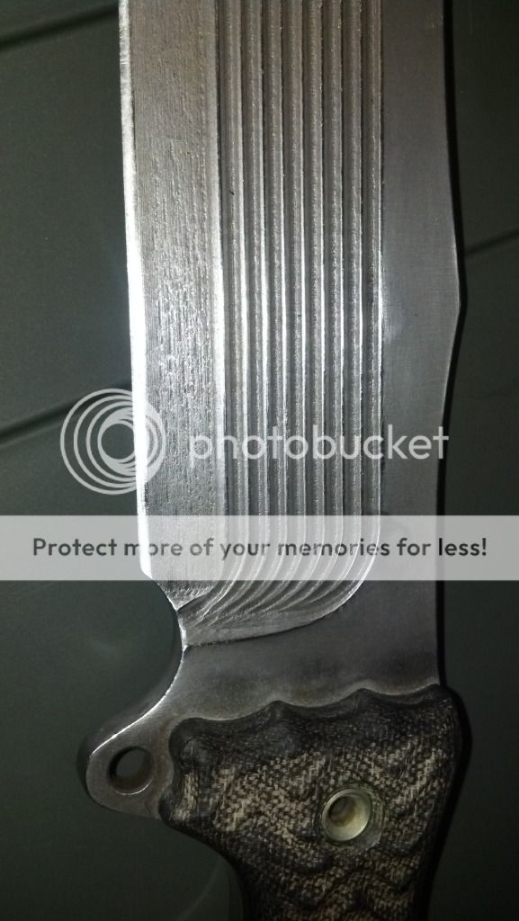

I have a stripped CGFBM and I think it looks great the way it is. I can get some pics when I get home. It will take a ton of work to get satin inside the CBT. I have seen a satin Hell Razor.

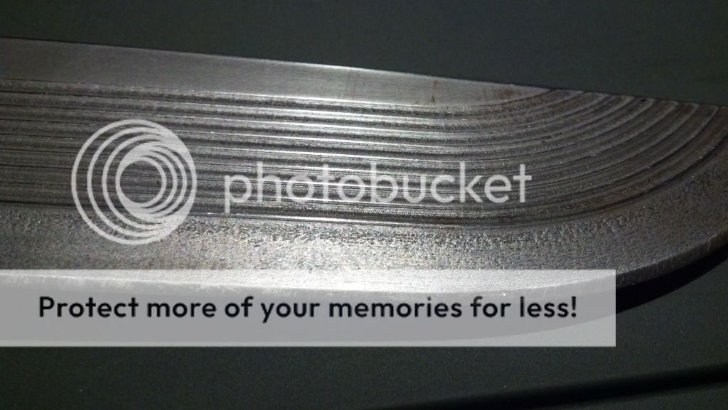

This is what it looks like under the coating
To get something like that you will have to remove the scales. Which isnt necessarily the hard part, putting them back on is if you dont have the right tools for flaring the tubes.
A satin CGFBM is a labour of love ... you need a couple of wedged shape pencil erasers and graduated grits of wet and dry paper ... strip the blade and use the erasers like a sanding block to wrap the wet and dry ... the wedge shapes let you get into the CBT's without removing metal on the tips of the grooves ... tape the two erasers together in the middle to get a decent sized "block" ... you don't have to remove the grips ... the rubber is soft enough to get inside the grip grooves right to the edge ... once you have a ghetto mirror finish ... use a scotch bright wheel to make it a brushed satin finish ... lots of patience and TLC and you will have a knife with your DNA impregnated into it and you will never sell that blade!
