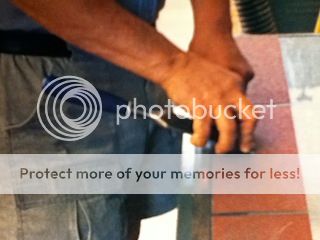

My real sharpening is done by hand.
With silicon carbide paper from Canadian Tire, on a granite floor tile I got from Rona.
Sometimes I use an old textbook as a backer instead of the tile...you know, making university pay off. ;)
