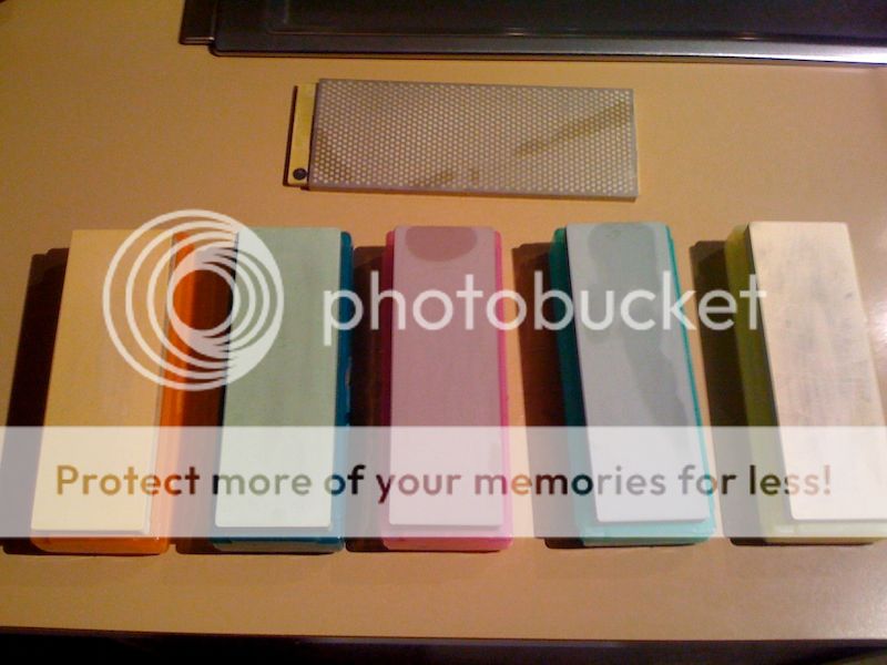

Don’t expect to sharpen the tuffer /harder tool steels/high alloy/super steels on the Ark.
Those steels just laugh at the Ark and make the stone shiny and remain dull.
The Ark is best for basic high carbon such as 1095.
See that shiny spot on my stone ? The whole surface of the stone got like that (only I couldn't get the camera to show it). All it took was I tried to do the final passes on a fully sharp A-2 blade. All I was doing was taking the wire edge off it after sharpening on lower grit water stones. There was no black looking marks on the stone like there would have been sharpening a basic high carbon blade. The stone just was not cutting the A-2 blade.
I was able to remove the glaze and get the stone cutting again (for the high carbon blades anyway) by running the stone on a diamond plate but I won’t waste my time with high alloy on an oil stone again. Works great for high carbon like razors, Opinels, Case CVs and stuff. Translucent Arks are really cool to have but . . .
For the tuffer harder stuff I would STRONGLY recommend a few Shapton water stones.
Hey if you ever considered getting a sharpening jig (I also strongly recommend that ) a vendor I just discovered and am soooooo glad I did . . . these guys are offering Shapton stones with their Edge Pro Apex Essentials Set. Good price too. And I like the company.
I bought one, I've used it . . . I Like It !
