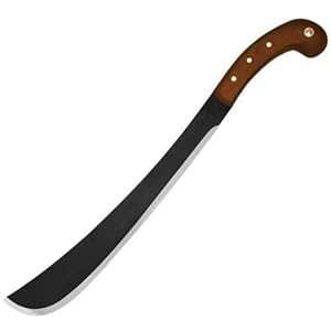

By way of reference.. this machete has 14" blade
That is a nice machete....i bought the parang instead (havent got to use it yet, been at school)
