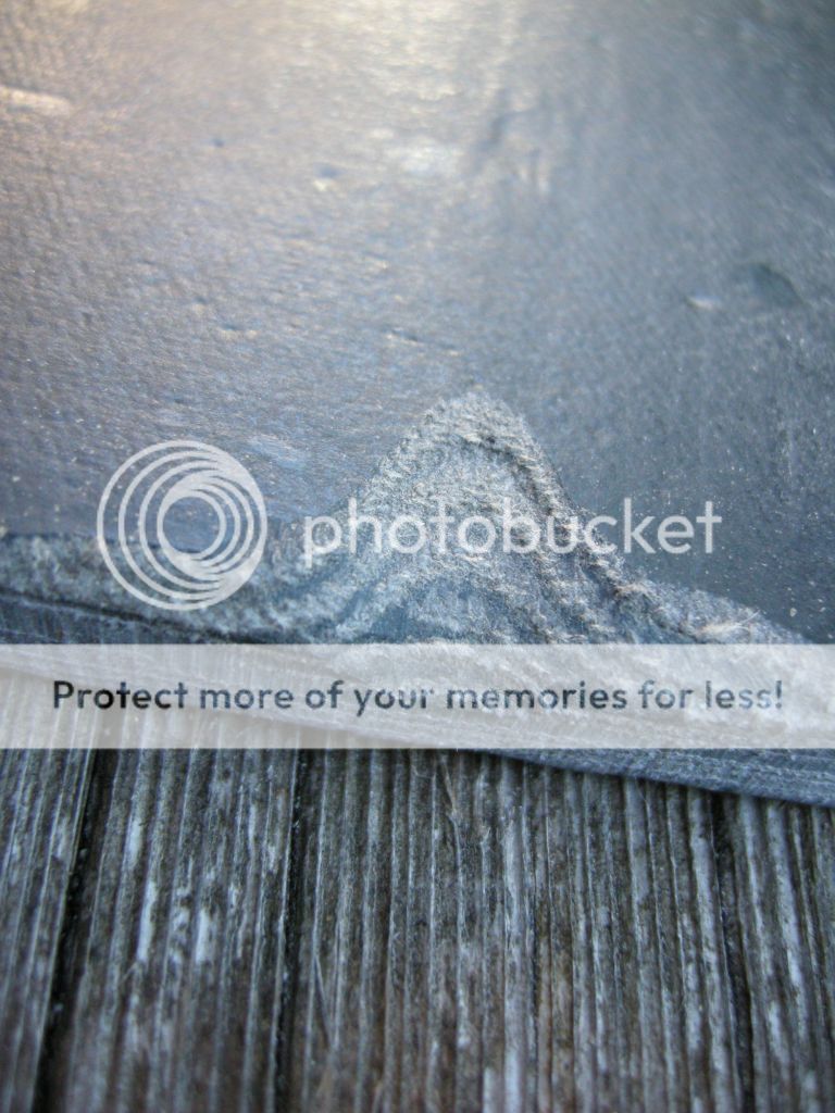

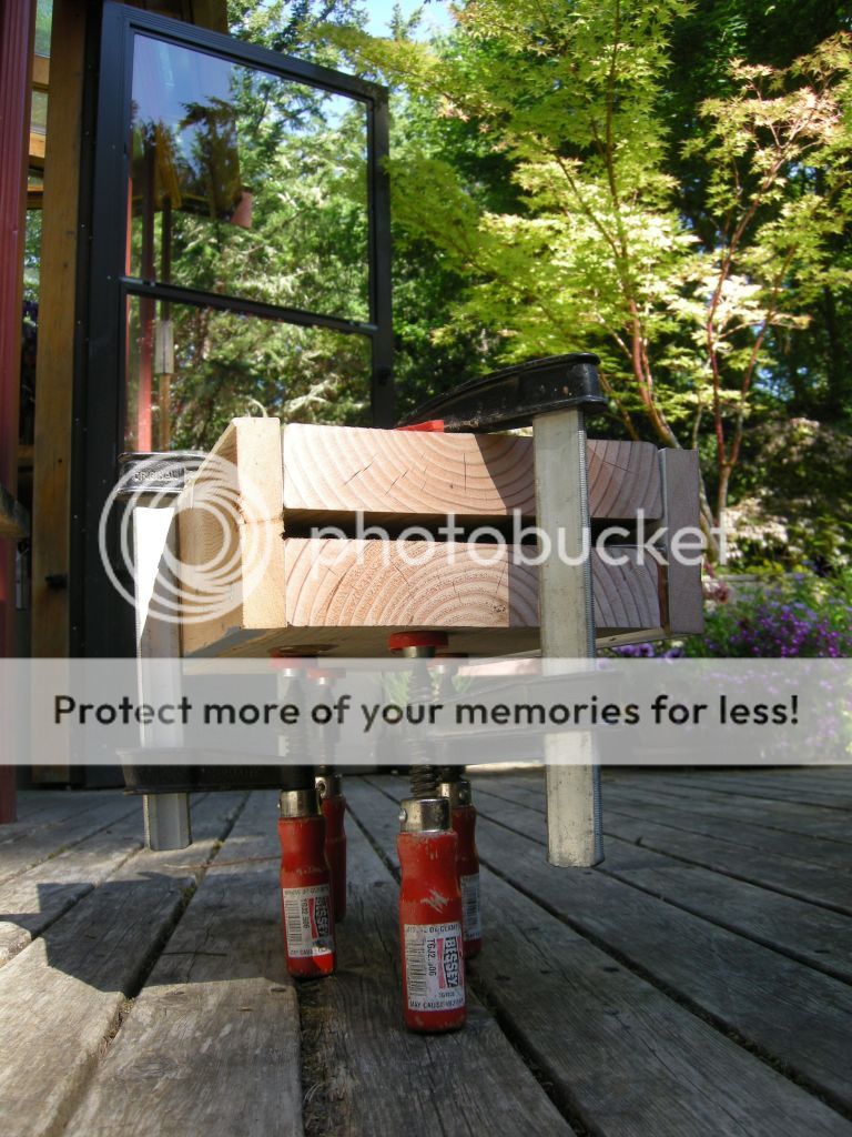

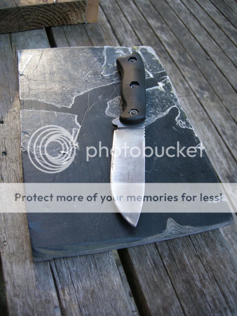

I got a BK15 a few days ago. Was at a sporting goods store and had to buy it as soon as I spied it hiding under a gerber. I figured since kbar hasn't released their factory micarta yet I'd make some of my own for the 16, 15 and maybe 14 as well.
Ok you guys can make fun of this picture...it's fair game.

3M polyester fiberglass resin bought at hardware store. About $15 and I used half a can (I think I used too much...had a lot ooze out the side). 1st time I've done this so I'm just kinda experimenting as I go. Seemed to work well. Set up fast tho. I was working against the clock to get all the layers of fabric stacked fast enough. It was about 90 outside yesterday and I'm sure that had a little to with the quick set :eek:

Better to have too much and let it ooze out than to have too little and have the micarta be dry and unusable.
I know the block is ugly, but that's just how my first one came out, too! :D Ended up working fine.
Also, as far as resins go, there is a marine epoxy resin with a 1:1 mix ratio. More expensive but smells much better and gives a longer open time (slower dry time).

If you get a 5"x10" sheet for ~$7, then you're getting good economy out of the process.
Usually a single stick of micarta suitable for one knife is about that price, and you'll get 3-4 out of a block like that.

I'll look into that. There is a boat building/marine supply store nearby that probably stocks something like that. I may be making another board soon. I used 17 layers of denim fabric and while it seems thick enough for 16/15/14 scales it may not for the full size grips.

And yes, I'm happy with the $7 investment...this stuff is cheap and easy to make. Now comes the hard part...shaping it!

I shoot for approximately 28/64 to 1/2 thick on the scales for the full size Beckers. I couldn't say how many layers that is. Kinda depends on the fabric.
