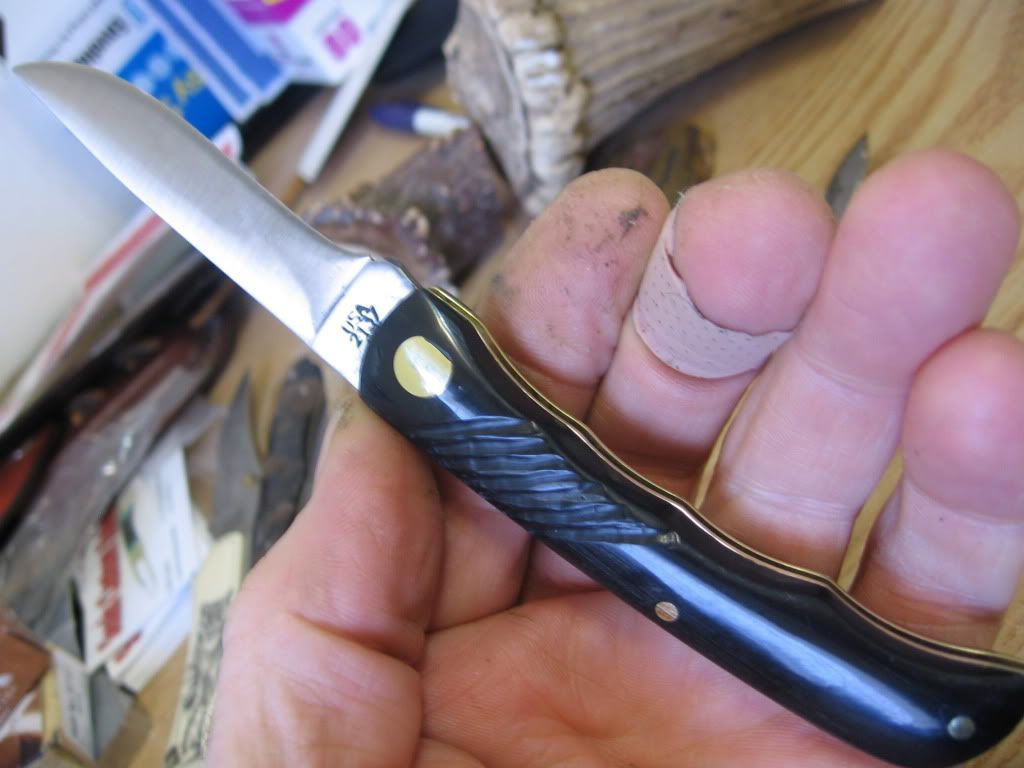

Here's one i slimmed and put finger grooves in.Also reprofiled the blade shape.Ugly,but cuts like a light saber!:D
seals i don't think ugly is the right word for that knife, i think it is absolutely wonderful looking, i haven't had time to do mine at work yet because we've been run over, but i was thinking i may try to get a deep shine out of the scales instead of the satin look, i need to just go dig out my belt sander (still boxed up from when we moved last year).
i also see that you have the mark of a knife crazed man also, the band aided finger. my stockman bit me pretty deep last night, and i was amazed at it's sharpness.

is there by chance enough room on the opposite end from the blade to drill a lanyard hole???
O,well thanks!:DI enjoy the reshaping and trying to do something a little different.Yea,I generally have at least one cut on the hand healing.I recently started wearing thin rubber or surgical style gloves just to keep my hands cleaner really,but its helped preventing the nicks.Havent had a serious cut in many years.(knocking wood)There is really no room at all for a lanyard.

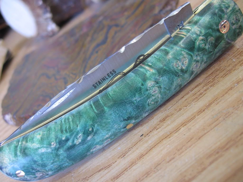

I was going to mention to try to stay away from the hinge pin, it's pretty shallow, but I guess the picture can tell you that.

Seals, what are you using for a pivot pin on the green one sir? Where can I find a similar pivot pin?
