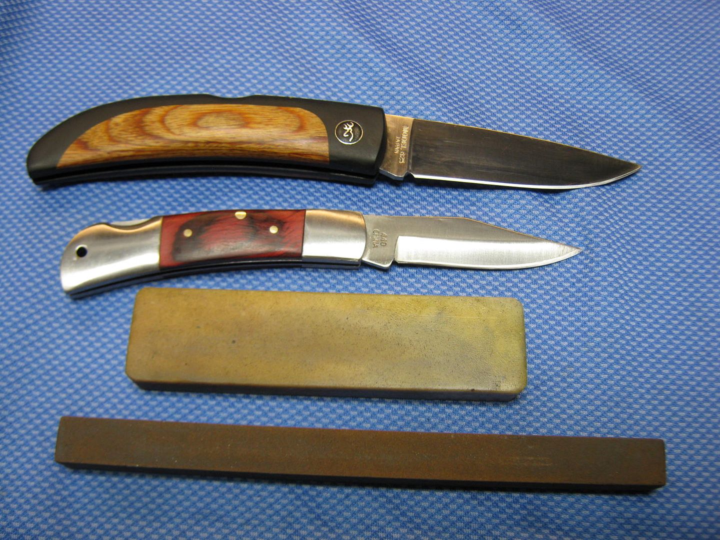

Tried a couple sharpening systems but didn't give them or myself a honest chance with either. also tried the DMT stones but wasn't sold on them. Decided to buy a TSprof system but not available until the end of November.
I decided I need to learn the basics before I got another system, I had a couple small cheap knifes a small lockback I got for joining the NRA and a Browning 825 lockback.
I have a small 1/2" x 1/2" Norton India stone and a 30 year old hard Arkansas stone I got in a kit with a Buck knife I believe.
So I did what I have learned on this forum raised a burr on both sides, cut it off and ran the blades on the hard Ark stone got decent results able to cut printer paper very cleanly.
Not quite able to cut hair off my arm but satisfied with the results so far. Both knifes are 440 so probably easy to sharpen I would assume? I am beginning to believe the the best system is knowledge and experience which I need more of both.
The fact that you've recognized this puts you ahead of the curve by a lot. ;) Now start getting a feel for different geometries, edge conditions and scratch patterns, and the way that bond strength and grit type can impact the sharpening process and you'll be a pro in no time. Also, try to avoid developing a burr if you can--it causes excessive wear on the edge. The only reason why people tell folks to raise a bur on the edge is it's an easy indicator that you've brought the bevel all the way to the apex. Learn to read the scratches of the stone on the edge bevel and you won't need it. You ideally want to be sharpening up to just shy of developing a burr--reaching the apex and not sharpening beyond that point. :)

Ahead of the curve OP! Congrats on your successes. I usually raise a burr on dull knives to know I've gotten the whole blade beveled because I can't see scratch marks like 42 can, my close vision is poor.
