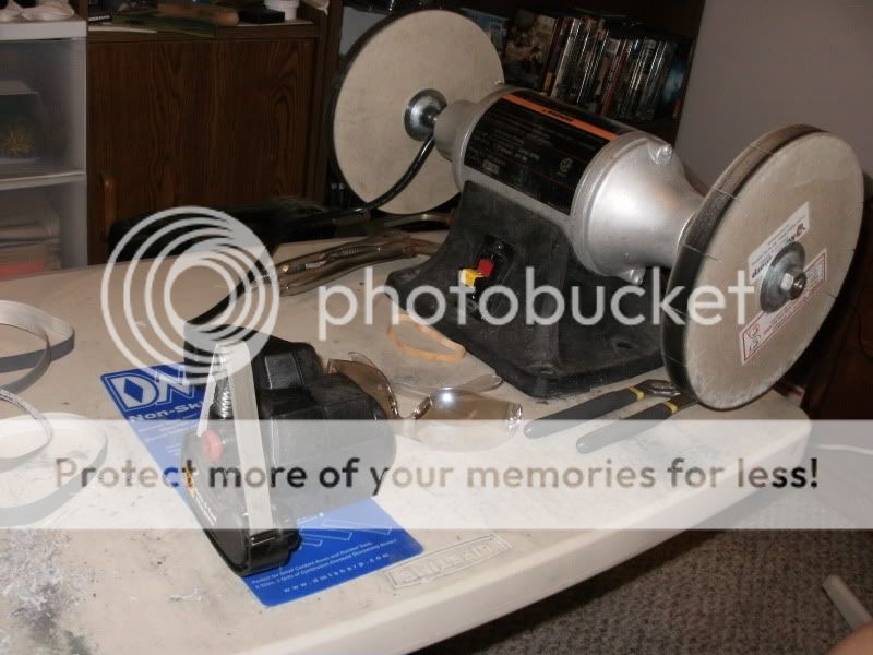

First, a picture of the Work Sharp next to my bench grinder & Paper Wheels(I clamp the thing down when sharpening, so don't give me lip about that):

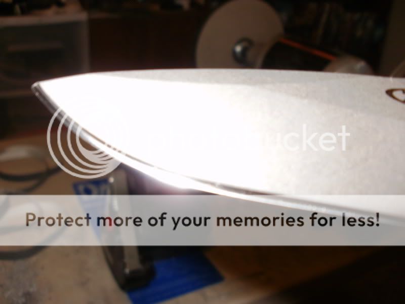

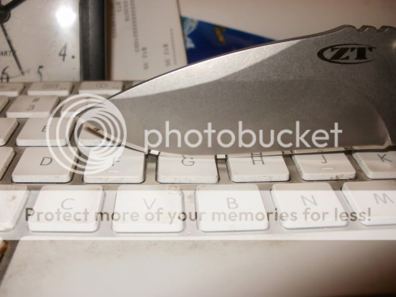

I have to say I'm glad I ordered the extra belts, as the 220 belt was WAY too aggressive and raised one hell of a wire edge. Sharpening was similar to the Paper Wheels, but it seems like it's much easier to round off your tip(should've practiced more before I moved onto my ZT 0551) due to the slack of the belt.
First impression is just WOW. I've never seen such pristine edges since my Edge Pro. If the edge was wider, I would literally be able to use it as a mirror.
Sharpness itself takes a little work, but I was able to take a swipe at my leg hairs and pop a couple off.
But enough talk, onto the pictures!
It's probably a little premature, but I think I'll do my Para 2 in S90V next:cool:.

My Para2 turned out nicely. There are still some factory grind lines(the steel is very tough to sharpen), but the parts that are mirror polished are very reflective, and the edge also pops a few hairs. I also managed to avoid rounding the tip:thumbup:. How's that for fast learning:p? The trick seems to be to lift the tip away at the very edge of the belt before it reaches the middle.

I ditched the guide after the first knife, feeling much more comfortable doing it freehand. So long as the angle held is accurate to within 3 degrees, it mostly seems to match the angle. And holding the knife perpendicular to the table seems to be exactly 20 degrees, so it's relatively easy to get your bearings from there. The sharpener does tend to move around on a hard surface, but the DMT Non-Skid Mat seems to cure that easy. I'm hoping to move on to my katana within the week:thumbup:.
