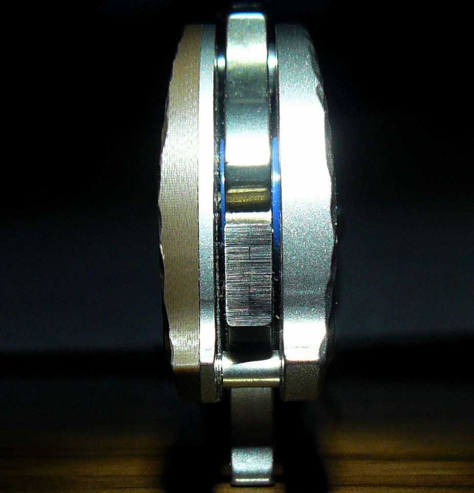

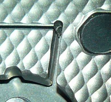

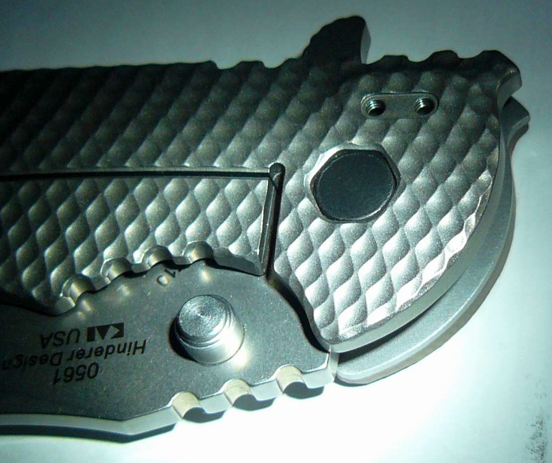

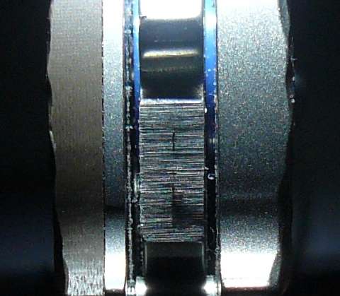

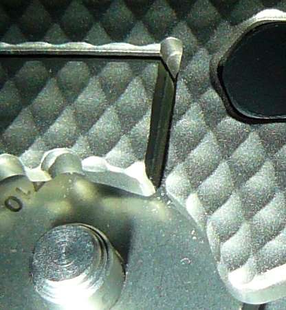

A few pics of my 561, no problems with this terrific knife, to show the targeted parts of the knife for your amusement:

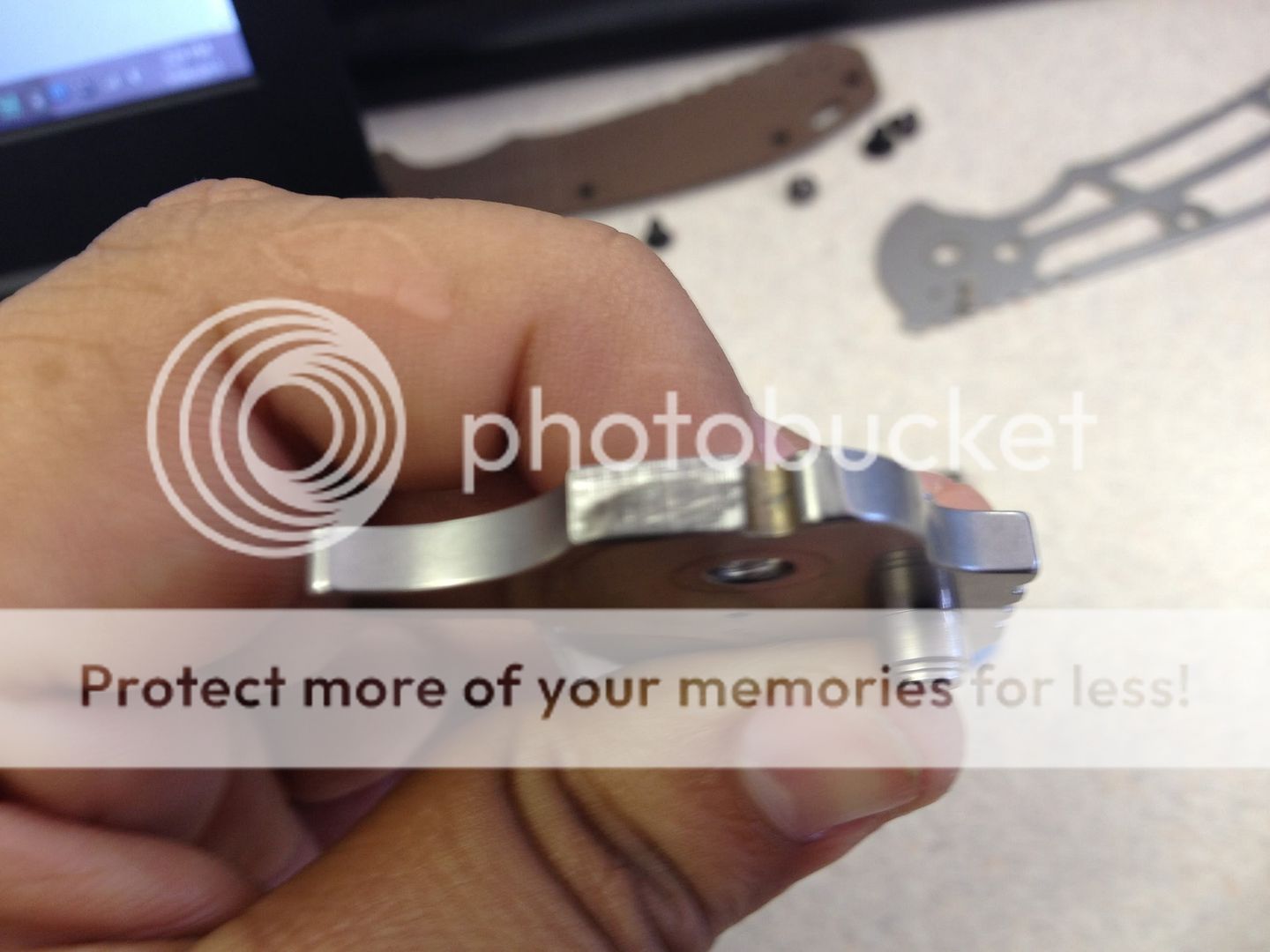

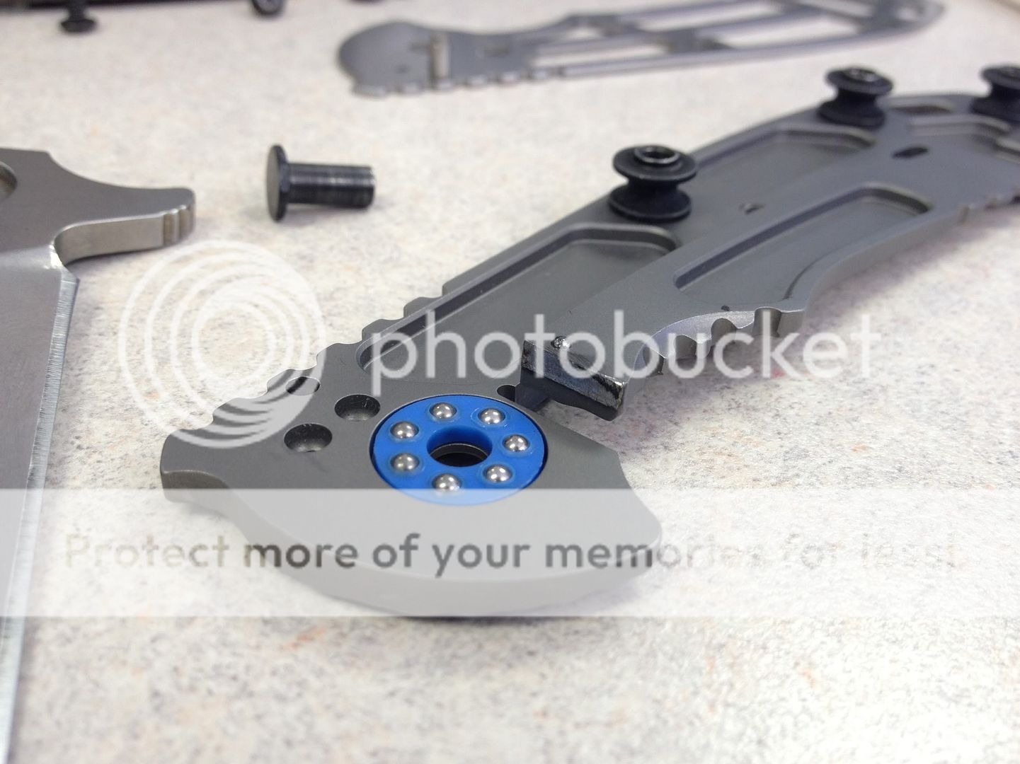

Carbidizing can mean two things from my understanding: Microwelding carbides unto the surface, or literally creating titanium carbide on the titanium it self (I am unsure how this process happens, what I do know is that it is expensive).
In the knife industry it appears they weld tungsten carbides, versus carbidizing the actual titanium. More than likely as a cost saving measure.
ZT never mentioned what they found wrong or what they fixed. They just said it was repaired.
The carbidizing was redone because when I sent it in what little it had out of the box had "chipped" off.
Lastly the blade tang has discoloration that was not there before and appears to be from hardening.
They do carbidize the frame lock from production for the ZT560/ZT561, mine out of the box however was not done properly I believe (half carbidized).
Anyways this is what true carbidizing in the knife industry is, you can see the crystalline structure of the carbides and it's "rough" appearance". When done properly it's way better than heat treating titanium (ex: CRK's method), and provides an extremely hard surface.
And lastly here's a video of carbidizing. The machine runs like $200-$300. Im sure there's others that are more expensive.
http://www.youtube.com/watch?v=x4JptL4nCi4

I can't swear that your lockbar face has had Tungsten placed onto it. The freshly carbidized surfaces in the videos look quite shiny, like Tungsten looks. And, now that I've watched three videos about plating with Tungsten I don't see any Tungsten on my lockbar mating surface. It looks like unadulterated Titanium to me. This makes me think, IMHO, that ZT doesn't carbidize the lockbar during manufacturing.
It is cool that anyone with one of these electric tools can build a hard surface on worn or sticky parts of the locking mechanism to fix problems and extend the working life of the knife.
First off what you see in my pictures is tunsgten carbidizing. No doubt about it, it is not the first time I've seen it in person. What you see on the tang is like I said, hardening not carbides thus the discoloration.
You can't really tell from the side too well. Take it apart and take a look.
I emailed them about lockbar surface carbidizing a while back and Kershaw responded saying they do carbidizie the lockbar surfaces and like I said out of the box new there was carbodizing but maybe not entirely as a patch was missing:
