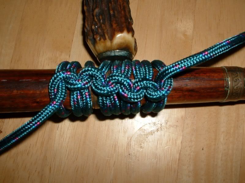

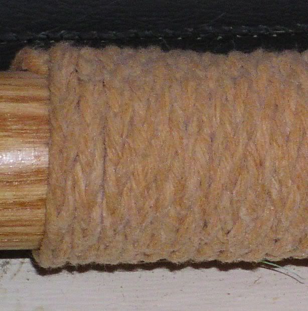

p.p.s. - i like the link you provided on the grip wrap. i use that on spears and clubs, knives and other things that need a slightly bigger or rougher grip, but i have used it without the loop. if you tug the base end after inserting the last turn in the top loop, you can pull the bitter end under the wrap near the top, and cut it off. i generally give it a coat of something to fix and waterproof it.
sample:
done with a three part braided string
same on a spear:
another one i use a lot is the turks head:
here on a tumbuk (spearhead mounted as a dagger). many S.E.Asian weapons have wooden
scabbards and are meant to be stuck under a waist sash. i like adding a wrap or turks head with a loop finish
which you stick the belt thru, as well as tucking the scabbard under the belt. keeps it from slipping out & getting lost

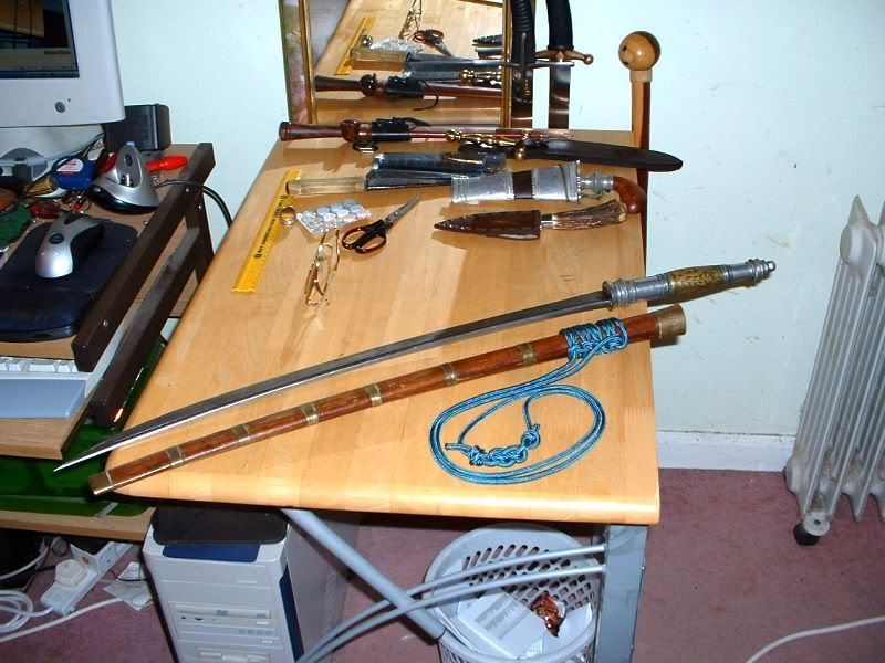

on swords, like the burmese dha, a rope baldric is used, the knot work can get creative.
and just to show off:
this is the whole dha in the first picture showing the whole baldric & it's flat terminating knotwork that spreads
the load on my shoulder...
