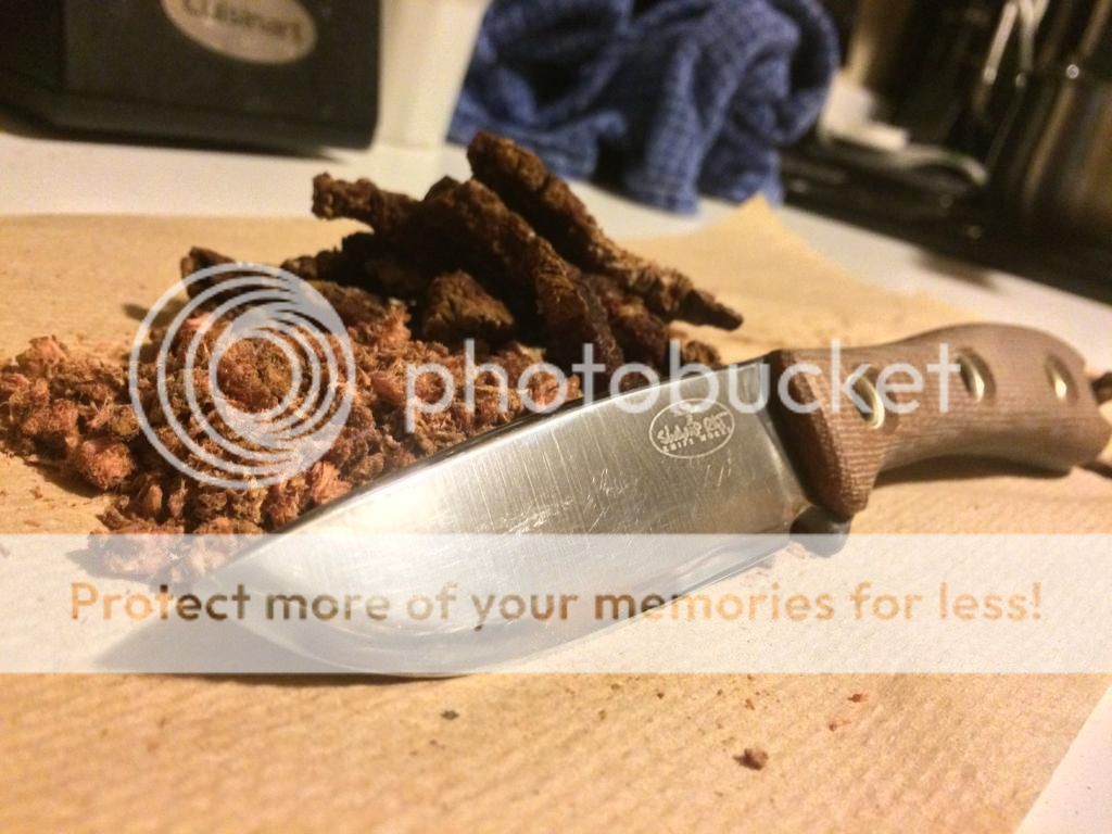

I fully convexed my Rodent solution.
Makes for a slightly more durable, easier to maintain edge.
Looks better too when stripped...
Just my opinion.
Shoot. That looks great. I bought some "stripper" from the local hardware store and tried it on a BKT. Did not work worth squat. what process/stripper did you use. I like the looks of my RS, but the Rodent 3 is awesome.
I used kleen-strip premium In a spray can.
Taped off the handles where I wanted to keep the coating.
Sprayed a thick layer of stripper on the blade and let sit for 15-20minutes.
Then I took rubber gloves and a green scotchbrite pad to take the coating off.
Then hand sanding to desired finish.
