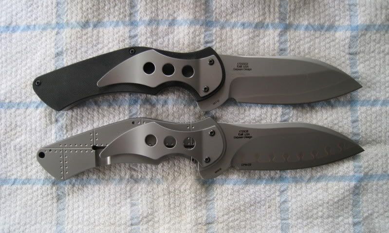

Like this?
The D2 Leek is way up on my "want to buy" list. Only blade I own in D2 is a BM 730 Ares, and it has a killer sharp factory edge. I am very glad more makers are producing knives with tool and other forms of non-stainless steels.
The regular D2 used by other mainstream manufactures is a very different beast from this CPM D2 as used by Kershaw and Spyderco Military Ltd. This CPM D2 beast is said to take a keener cleaner edge and will take a harder by 1,2 point HrC temper while retaining the same toughness and at the same time is more stain resistant. So this CPM D2 is the real ants piss compared to regular D2.

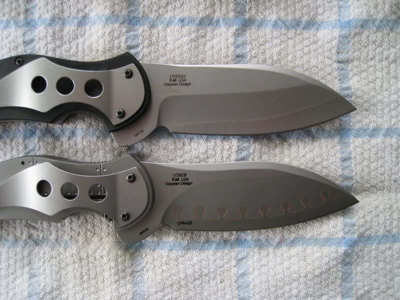

The reason Kershaw makes the composite blade is because its prohibitively expensive to make the whole blade out of CPM D2. Besides the weld line makes for a very pretty blade while giving a cheeper price and hard edge with softer spine.
By the way, there is another variant called Friction Forged D2 which makes regular D2 behave like CPM D2.
CPM D-2 is right up there with SG2 and ZDP in my book!
Fairly high praise- if CPM D2 compares favorably with steels such as these, it makes the D2 Leek one of the best values on the market.
ZDP-189 is still a monster compared to CPM D-2, and SG2 has a bit of an edge as well (both in alloy and hardness). However, CPM D-2 does have an excellent balance of toughness and edge holding. My best comparison would be with the old M-2 knives from Benchmade.
Don't mean to speak for SPX, but I think he was just saying that CPM-D2 is in the same group as ZDP-189 and SG2 because it has so many great qualities. I don't think he was saying that they are all the same, just that they are all great steels for their own individual characteristics.
I think it's great that we have several "super steels", each with their own "personality" that can be applied to different areas of need. ZDP will hold an edge FOREVER, SG2 will whittle peach fuzz, and CPM-D2 will do a little bit of both!
